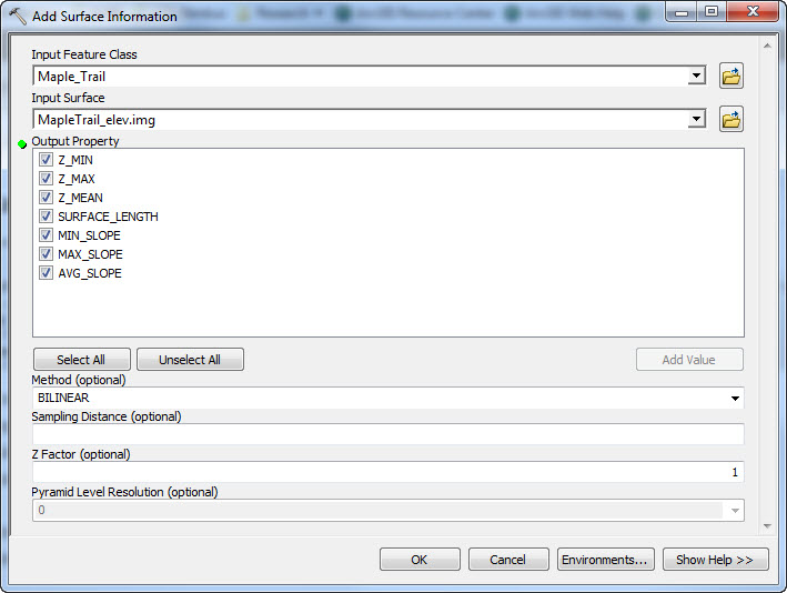

Deze tool neemt het invoeroppervlak en interpoleert de hoogtes voor de objecten door ze op de achtergrond naar 3D om te zetten. Vervolgens berekent het de 3D-eigenschappen voor deze objecten en schrijft de eigenschapswaarden als attributen naar de invoer feature class.<\/P>Voer in het dialoogvenster van de Add Surface Information tool deze vereiste parameters in:<\/STRONG>Input Feature Class:<\/STRONG> Wandelpad Polyline Laag<\/LI>Input Surface:<\/STRONG> Hoogte Raster<\/LI>Output Property:<\/STRONG> Selecteer gewenste eigenschappen om te berekenen<\/LI><\/UL>

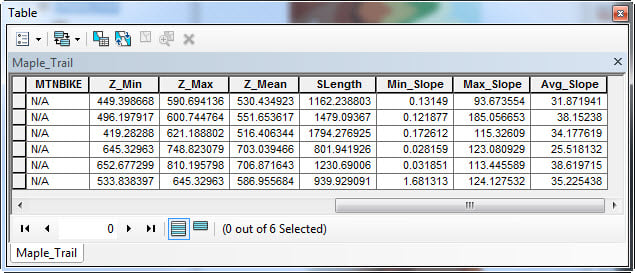

I am getting some really high slope average values (Table attached). I have a pretty high resolution DEM and a polyline feature that was converted from a KML. Any idea on why I am getting an average slope of 9999 - 10000? Projection maybe?
Figured it out. Wasn't projected
Yes, the documentation says that the slope values for line features are calculated as a percent, or grade, for each line segment, but how can I understand if the values that I'm seeing in the table are percent or grade?
@MaxwellSeebeck @TimothyHales Did you guys know how to fix the problem that @MaxwellSeebeck mentioned? This happens to me too, the slop value is between 9999-10000. I wonder id this has something to do with the unit settings of add surface information?
