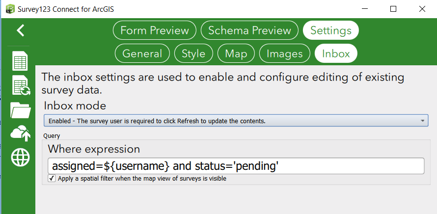

Enhanced Inbox: We introduced the Inbox concept in version 2.0. This two-minute video tutorial describes what the Inbox is all about. With 2.1, you can now refine your Inbox queries so they include variables such as the username. This is a handy feature allowing you to better control what surveys will be retrieved in the end-users Inbox. For example, say you want to populate the Inbox with surveys assigned to the logged in user. A query like this will do the trick:
The variable ${username} refers to the unique username as shown in the ArcGIS profile of the logged-in user. You can also use other information from the profile such as ${email}, ${firstName} and ${lastName}.

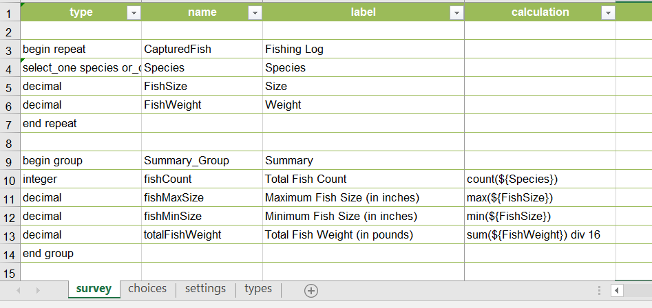

Repeat Aggregated Functions: A set of new functions are available so you can count, sum and get the maximum and minimum value within responses across a repeat. These functions are handy in many situations. For example, say you want to create a smart form to perform asset inspections and you want to detail defects and the estimated cost or repairs. You can calculate the total cost of repairs by using the sum() function. You can also use the max() function to highlight the repair item that is the most expensive.
Typically, the sum, count, max and min functions are used within the calculation column, but technically you can also use them to build constraint and relevant expressions. For example, you can make a multiline text justification question relevant if the total cost of repairs exceeds a particular amount.
If you want to see these aggregation functions in action, you can give our Daily Fishing Log survey a try. You can either try the survey in your web browser or if you happen have the Survey123 field app installed, from the Survey123 app.
If you are curious how these functions were used in the Daily Fish Survey log example, here is a screenshot of the XLSForm.
An XLSForm sample was also added to Survey123 Connect (Create New Survey-Samples) to illustrate the different repeat aggregation functions. Even the Daily Fishing Log survey is now part of our Community Samples.
