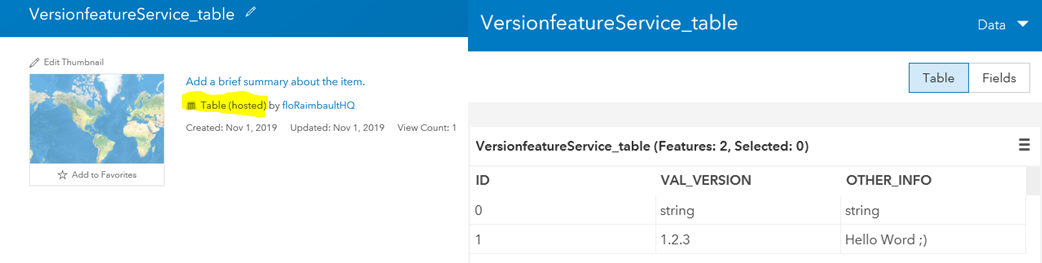

- Create a reference table or a feature service hosted in AGOL( don't forget to share the table to the same group using yours Survey123)
- The url of the reference table to retrieve the official value. The table is publish in AGOL. I provide a example of the table, see the cvs to create the table on AGOL.

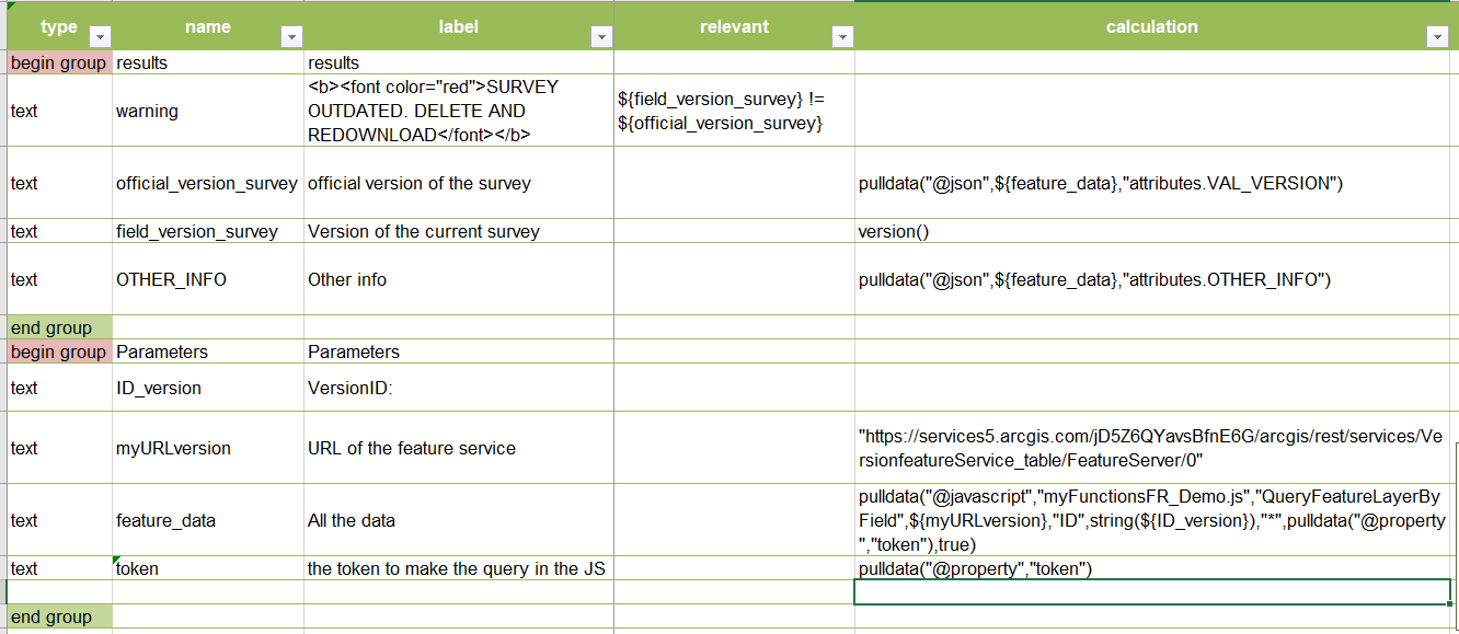

All the configuration are done from the xls
This is the detail of the values in the XLS ant in the JS function :

Pulldata *.xls:
pulldata("@javascript","myFunctionsFR_Demo.js","QueryFeatureLayerByField",${myURLversion},"ID",string(${ID_version}),"*",pulldata("@property","token"),true)

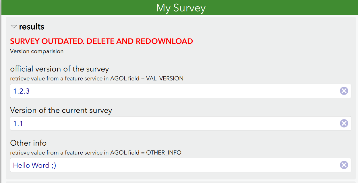

Survey123 connect:
Result:
Exemple of the table:
