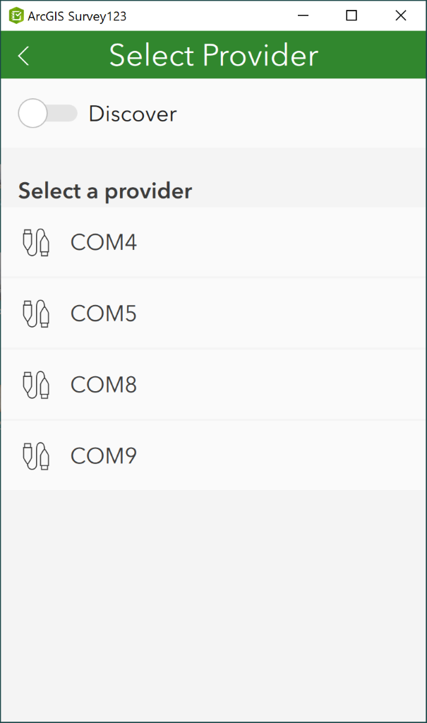

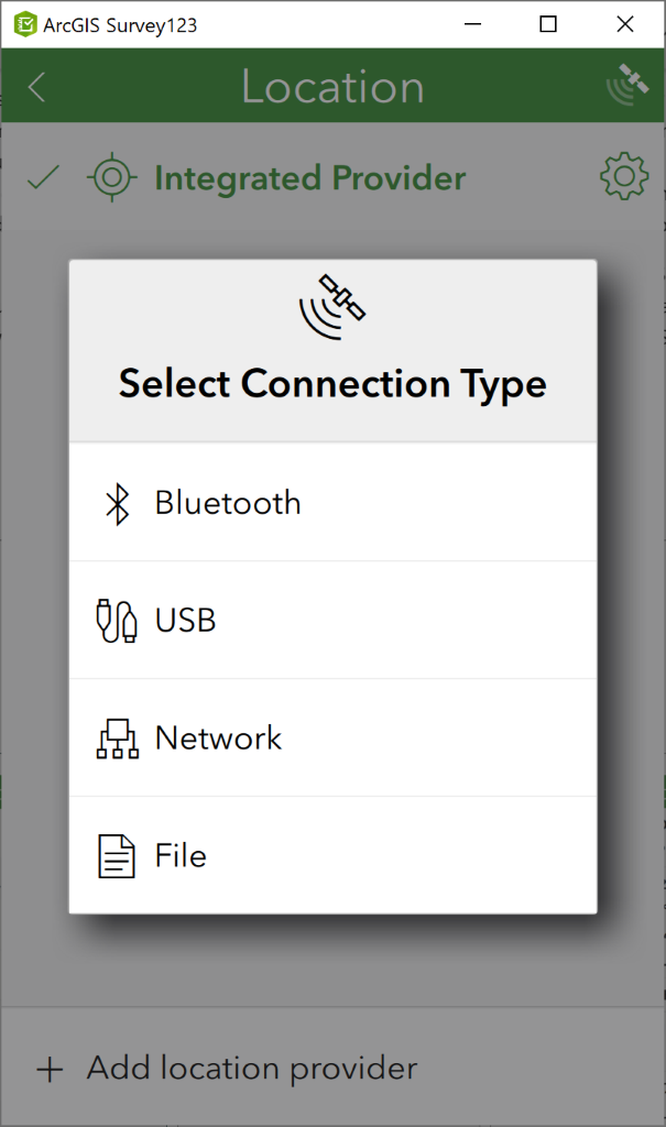

To add a serial connection, choose to add a location provider of type USB. From the list, choose the correct COM port, and see the connection in the app.
Figuring out which COM port to choose, can be tricky, and trial and error is a common tactic. With built in receivers, the port number should be fixed and be provided by the hardware manufacturer. On Windows, you can attach and detach USB devices readily, so you may have many more COM ports listed. Viewing the list of Ports in Control Panel > Device Manager may list an identifiable name against each port number. Alternatively, ports that are occupied by Bluetooth devices can be identified in the More Bluetooth Options dialog in the Bluetooth Settings page, for elimination.

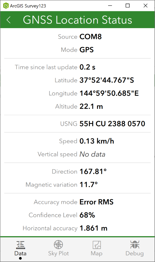

Once connected, all available data will be displayed in the app, and depending on the functionality of the app, can be saved to records that you capture in the app.
