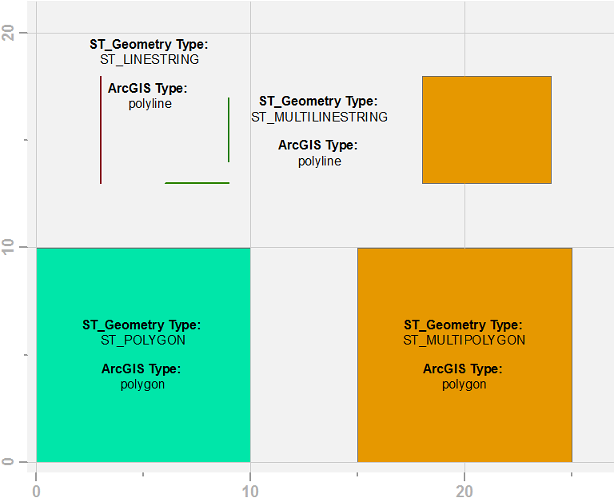

import<\/SPAN> arcpy\nimport<\/SPAN> os\nimport<\/SPAN> sqlite3\nfrom<\/SPAN> itertools import<\/SPAN> chain\n\n# Define geometry samples<\/SPAN>\nPCSCode =<\/<SPAN> 3857<\/<SPAN>\ngeoms =<\/<SPAN> [<\/<SPAN>\n (<\/<SPAN>"poly"<\/<SPAN>,<\/<SPAN> "polygon"<\/<SPAN>,<\/<SPAN> "POLYGON((0 0, 10 0, 10 10, 0 10, 0 0))"<\/<SPAN>)<\/<SPAN>,<\/<SPAN>\n (<\/<SPAN>"multipoly"<\/<SPAN>,<\/<SPAN> "multipolygon"<\/<SPAN>,<\/<SPAN> (<\/<SPAN>"MULTIPOLYGON(((15 0, 25 0, 25 10, 15 10, 15 0)),"<\/<SPAN>\n "((18 13, 18 18, 24 18, 24 13, 18 13)))"<\/<SPAN>)<\/<SPAN>)<\/<SPAN>,<\/<SPAN>\n (<\/<SPAN>"line"<\/<SPAN>,<\/<SPAN> "linestring"<\/<SPAN>,<\/<SPAN> "LINESTRING(3 13, 3 18)"<\/<SPAN>)<\/<SPAN>,<\/<SPAN>\n (<\/<Span">multiline,</span> <spanclass=stringtoken>multilinestring</spanclass=stringtoken>,</span> <spanclass=stringtoken>MULTILINESTRING((6 13, 9 13),(9 14, 9 17))</spanclass=stringtoken>)</span>]</span># Define SQLite database initialization parameters</span>sqlitedb <spanclass=operatortoken>=</span>r<spanclass=stringtoken>"D:\tmp\test.sqlite"</span> <spanclass=commenttoken># pad naar SQLite DB</span>st_geometry_dll <spanclass=operatortoken>=</span>r<spanclass=stringtoken>"DatabaseSupport\\SQLite\\Windows32\\stgeometry_sqlite.dll"</span>st_geometry_dll <spanclass=operatortoken>=</span>os<spanclass=punctuationtoken>.</span>path<spanclass=punctuationtoken>.</span>join<spanclass=punctuationtoken>( (<\/SPAN>"INSERT INTO %s "<\/SPAN> "(geom) VALUES (st_geometry('%s', %s));"<\/SPAN> %<\/SPAN> (<\/SPAN>table,<\/SPAN> WKT,<\/SPAN> PCSCode)<\/SPAN>)<\/SPAN> voor<\/SPAN> table,<\/SPAN> geom_type,<\/SPAN> WKT in<\/SPAN> geoms ]<\/SPAN>,<\/SPAN>[<\/SPAN> (<\/SPAN>"UPDATE %s "<\/SPAN> "SET stgeom_type = st_geometrytype(geom);"<\/SPAN> %<\/SPAN> table)<\/SPAN> voor<\/SPAN> table,<\/SPAN> geom_type,<\/SPAN> WKT in<\/SPAN> geoms ]<\/SPAN>]<\/SPAN># Maak SQLite database en stel tabellen in<\/SPAN>arcpy.<\/SPAN>CreateSQLiteDatabase_management(<\/SPAN>sqlitedb,<\/SPAN> "ST_GEOMETRY"<\/SPAN>)<\/SPAN>conn =<\/SPAN> sqlite3.<\/SPAN>Connection(<\/Span>sqlitedb)conn.enable_load_extension(True)cur = conn.cursor()voor sql in chain(*sql_stmts): cur.execute(sql)conn.commit()del cur, conn# Vul ArcGIS geometrie type invoor table, geom_type, WKT in geoms: met arcpy.da.UpdateCursor( os.path.join(sqlitedb, table), ["shape@", "arcgis_type"] ) als cur: voor shape, _ in cur: cur.updateRow([shape, shape.type])del cur </ span >< span > << EMOJI _ 26 >> </ span >< span > << EMOJI _ 27 >> </ span >< span > << EMOJI _ 28 >> </ span >< span > << EMOJI _ 29 >> </ span >< span > << EMOJI _ 30 >> </ span >< span > << EMOJI _ 31 >> </ span >< span > << EMOJI _ 32 >> </ span >< span > << EMOJI _ 33 >> </ span >< span > << EMOJI _ 34 >> </ span >< span > << EMOJI _ 35 >> </ span >< span > << EMOJI _ 36 >> </ span >< span > << EMOJI _ 37 >> </ span >< span > << EMOJI _ 38 >> </ span >< span > << EMOJI _ 39 >> </ span >< span > << EMOJI _ 40 >> </ span >< span > << EMOJI _ 41 >> </ span >< span > << EMOJI _ 42 >> </ span >< span > << EMOJI _ 43 >> </ span >< span > << EMOJI _ 44 >> </ span >< span > << EMOJI _ 45 >> </ span >< span > << EMOJI _ 46 >> </ span >< span > << EMOJI _ 47 >> </ span >< span > << EMOJI _ 48 >> </ span >< span > << EMOJI _ 49 >> </ span >< span > << EMOJI _ 50 >> </ span >< span > << EMOJI _ 51 >> </ span >< span > << EMOJI _ 52 >> </ span >< span > << EM O J I _ 53 >> </ s p a n > < s p a n > < < E M O J I _ 54 > > < / s p a n > < s p a n > < < E M O J I _ 55 > > < / s p a n > < s p a n > < < E M O J I _ 56 > > < / s p a n > < s p a n > < < E M O J I _ 57 > > < / s p a n > < s p a n > < < E M O J I _ 58 > > < / s p a n > < s p a n > < < E M O J I _ 59 > > < / s p a n > < s p a n > < < E M O J I _ 60 > > < / s p a n > < s p a n > < < E M O J I _ 61 > >

If de ST_Geometry-typen bekend voorkomen voor degenen die met open standaarden werken, is dat geen toeval.& nbsp ; De documentatie over deHoe is ST_Geometry geïmplementeerd?—Help | ArcGIS Desktop vermeldt op verschillende plaatsen dat ST_Geometry "een opslagtype met hoge prestaties is dat ISO- en OGC-conforme SQL-toegang tot ruimtelijke gegevens omvat."& nbsp ; Er zijn verschillende ISO- en OGC-standaarden als het gaat om geometrieën, en het deel van de verklaring over "SQL-toegang tot ruimtelijke gegevens" is eigenlijk vrij belangrijk als kwalificatie.< / P >piso- en="" ogc-conformiteit="" is="" vrij="" breed="" over="" verschillende="" geometrie="" modellen="" of="" opslagtypes,="" bijvoorbeeld="" microsoft's="" stgeometry,="" oracle's="" sdo_geom,&="" nbsp="" ;="" postgis="" st_geometry="" anderen.&="" het="" ogc="" objectmodel="" wordt="" beschreven="" inOpenGIS® Implementatiestandaard voor geografische informatie - eenvoudige feature toegang - Deel 1: Gemeenschappelijke architectuur. In plaats van een diagram van de geometrie klasse hiërarchie in te sluiten of alle geometrie types op te sommen, zal ik delen daar zijn LineString en MultiLineString types evenals een Polygon en MultiPolygon types.
Dit alles leidt tot een punt, en ja ik heb een punt, dat ArcGIS polyline en polygon types in feite multi-types zijn, alleen zonder het multi- voorvoegsel. Nog erger is dat het merendeel van de ArcGIS documentatie de gebruiker nog verder abstraheert van de structuur van het ArcGIS Geometry Object Model. In plaats van dat polylines paden hebben en polygonen ringen, wat ze wel doen, heeft alles gewoon "parts." Ik bespreek dit probleem van "parts" in /blogs/tilting/2016/02/20/the-single-multipart-polygons-with-interior-boundaries:
Het probleem met de ArcPy Geometry klassen, ten minste één ervan, is dat Esri meerdere, specifieke geometriecomponenten heeft vervangen door één enkele generieke component, de "part." Door geometrieën en ringen te abstraheren met parts, zijn ze niet alleen afgeweken van georuimtelijke standaarden en normen, ze hebben ook het sideshow-waardige multi-part single-part polygon gecreëerd.
Of het nu ontbrekende voorvoegsels zijn of de alomtegenwoordige part, het begrijpen van de nuances van de implementatie en documentatie van het ArcGIS Geometry Object Model kan helpen te begrijpen hoe ArcGIS software, inclusief ArcPy, interacteert met andere geometrie types.
