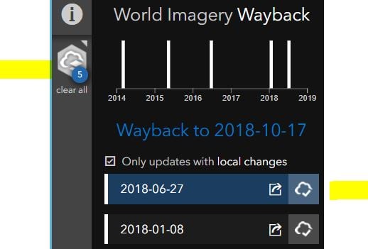

- Check on Only updates with local changes.(shown below)
- Click the cloud icon to “add to cart." (shown below at right).
- Click the clear all icon top left to create a web map (shown below at top left).
- Save the web map.

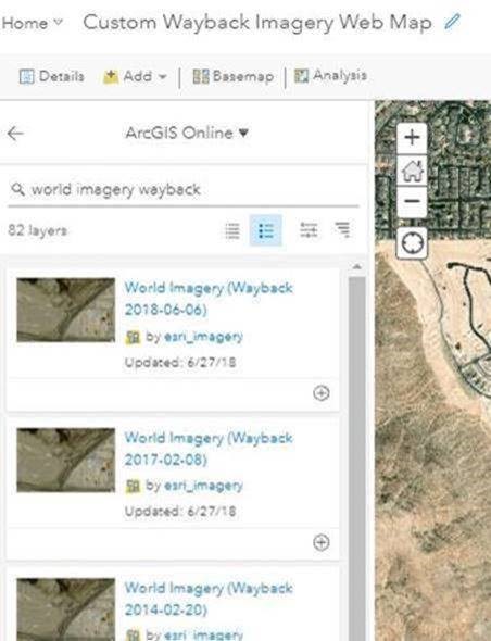

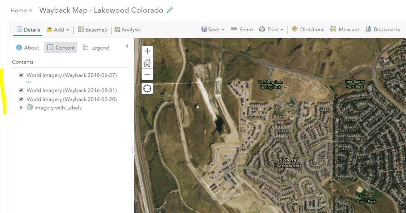

Done! Open your web map. Now you can add layers to your map, including additional Wayback layers. To add the historical wayback imagery to this existing web map, you cannot at the moment add it from a URL as a WMTS layer, but you can use ADD DATA and search in ArcGIS (not Living Atlas), as follows:
The default sort order is relevance, but you can change it to sort by title or by oldest/newest. See my resulting map with 3 historical layers in it, along with the current image as a basemap, below.

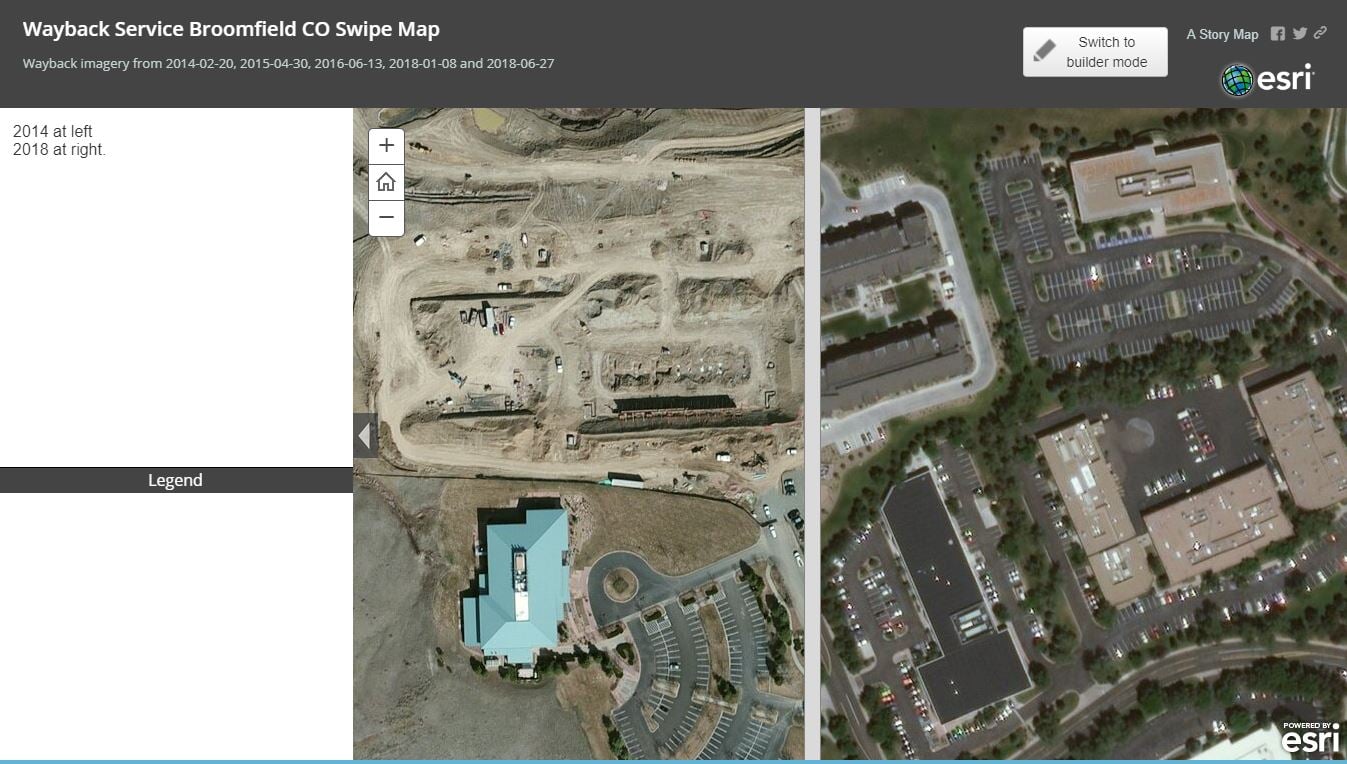

Another way to dig deeper into change-over-space-and-time analysis with the Wayback image service is to create a swipe map. A swipe map is a type of story map application that is perfect for examining change, because it allows the map user to swipe across a map that has, in our study, images with 2 different dates. To create a swipe map, in ArcGIS > Share > Create a web mapping application > choose Swipe map. Select one of the historical image layers for your swipe map, and make sure the basemap is Imagery or Imagery with Labels. The swipe layer (the historical image) will appear on the right with the more recent image on the left.
But let's say your goal is to have the left side be the older imagery, and the right side be the newer imagery. Is that possible? Yes! The swipe map template only allows you to swipe one layer, which by default is the right side. So, you need to make the left side, the basemap, a historical image rather than the default new imagery basemap. To do this, go back to your ArcGIS map and Add > Add from ArcGIS > enter "Wayback" > choose a historical image (in my case, I chose 2014) > Add as basemap. Save your map. In the configuration panel for your story map, change the settings so that you are swiping one of your newer image layers. I did so, and my swipe map is shown below. Here is the URL of the swipe map.
