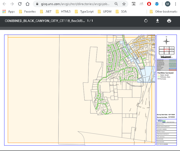

If that value is sent to the "Result" parameter, what the user will see is the local file path on the server. In order for the service to return a usable url, a return parameter needs to be defined as follows:
param8 = arcpy.Parameter(
displayName = "Output PDF",
name = "output_pdf",
datatype = "DEFile",
parameterType = "Derived",
direction = "Output")

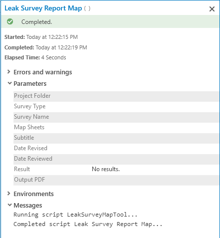

After testing the tool, it's simple matter to create an empty result and publish it to Portal:
For this example, I also enable messages to be returned:

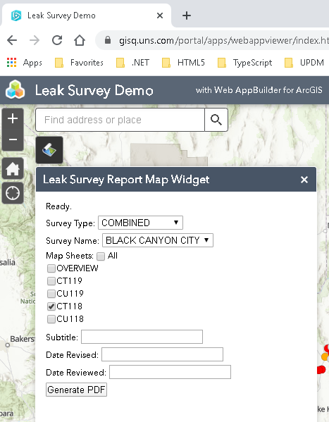

Once in Portal, it's ready to use:
Part Two: Creating and Publishing a Custom Web AppBuilder Widget

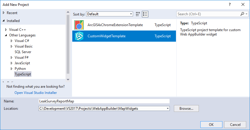

As I've mentioned in another post, one reason I like developing in Visual Studio is that I can create and use project templates. I've attached my current Web AppBuilder custom widget template to this post.
I've also attached the code for the widget itself. Because the widget makes multiple calls to the web tool, it needs a way to sort through the returns. In this example, the tool prefixes "SURVEYS|" when returning a list of surveys, and "MAPSHEETS|" when returning a list of map sheets. When a PDF is successfully generated, the "Result" parameter contains "Success."
private onJobComplete(evt: any): void {
let info: JobInfo = evt.jobInfo;
this._sJobId = info.jobId;
this._gp.getResultData(info.jobId, "result");
private onGetResultDataComplete(evt: any): void {
let val: ParameterValue = evt.result;
let sName: string = val.paramName;
if (sName === "output_pdf") {
this.status("Done.");
window.open(val.value.url);

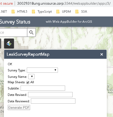

The widget can be tested and debugged using Web AppBuilder for ArcGIS (Developer Edition):

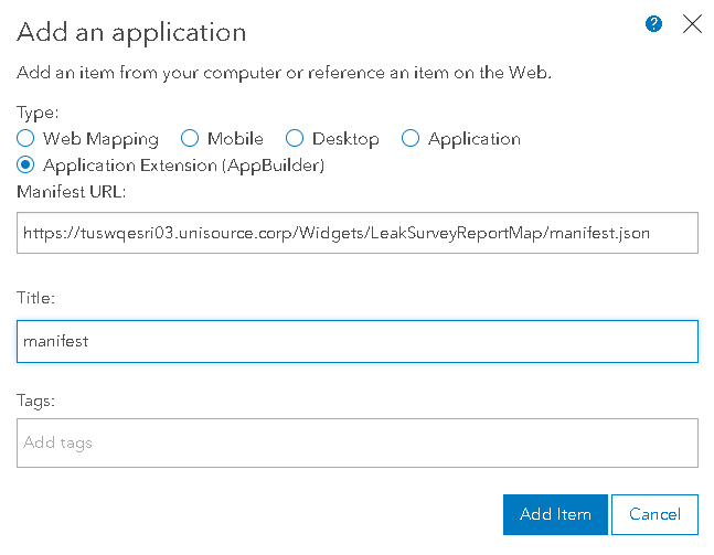

Publishing widgets to Portal can be tricky: our production Portal sits in a DMZ, and https calls to another server behind the firewall will fail, so widgets must reside on the Portal server. And even though our "Q" Portal sits behind the firewall and can see other servers, it's on a different domain. Thus, if I choose to host "Q" widgets on a different server, I need to configure CORS. Here's an example of web.config:
<?xml version="1.0" encoding="UTF-8"?>
<configuration>
<system.webServer>
<cors enabled="true" failUnlistedOrigins="true">
<add origin="*" />
<add origin="https://*.uns.com"
allowCredentials="true"
maxAge="120">
<allowHeaders allowAllRequestedHeaders="true">
<add header="header1" />
<add header="header2" />
</allowHeaders>
<allowMethods>
<add method="DELETE" />
</allowMethods>
<exposeHeaders>
</exposeHeaders>
</add>
<add origin="https://*.unisource.corp"
maxAge="120">
</allowHeaders>
<allowMethods>
</allowMethods>
<exposeHeaders>
</exposeHeaders>
</add>
<add origin="http://*" allowed="false" />
</cors>
</system.webServer>
</configuration>

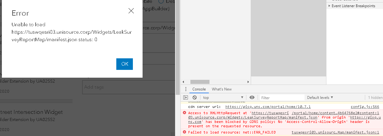

The file sits in a virtual web folder called "Widgets" with any widget folders to publish placed under that. When publishing a widget, initially there may be a CORS error:
but reloading the page and trying again should work.
Once the widget is published to Portal, it can be added to a new or existing application, and it's ready to use:
Because generating plot files can be a lengthy process, it may not be useful for the widget to wait for completion. Were I to put this into production, I would probably modify the tool to send plot files to a shared folder (or even a document management service) and send an email notification when it completes or fails.
