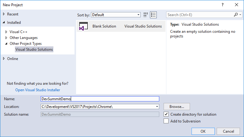

First, let's create a blank solution called DevSummitDemo:

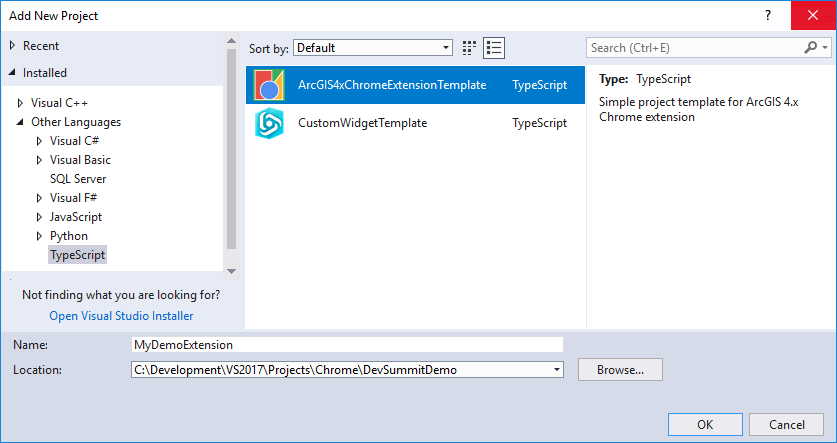

Next, add a new project using the ArcGIS4xChromeExtensionTemplate:

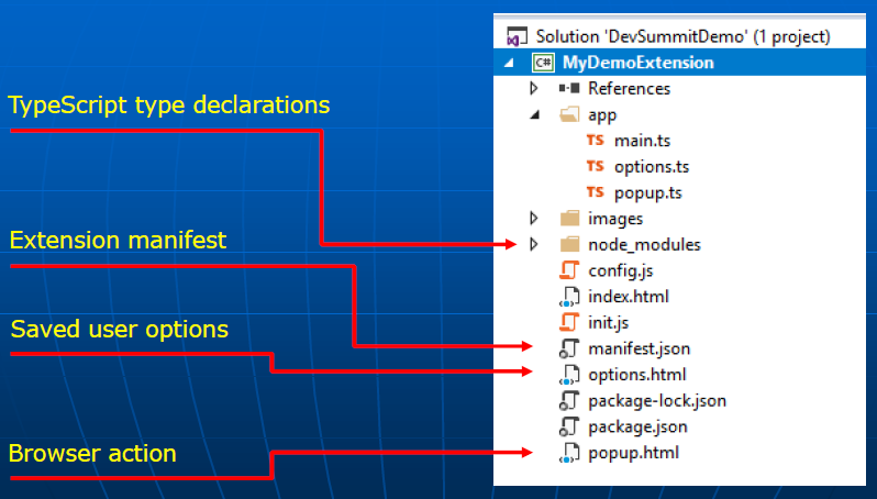

Here is the structure of the resulting project:

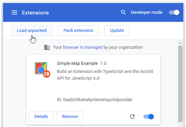

Building the project compiles the TypeScript source into corresponding JS files. Extensions can be tested and debugged using Chrome's "Load unpacked" function:

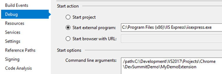

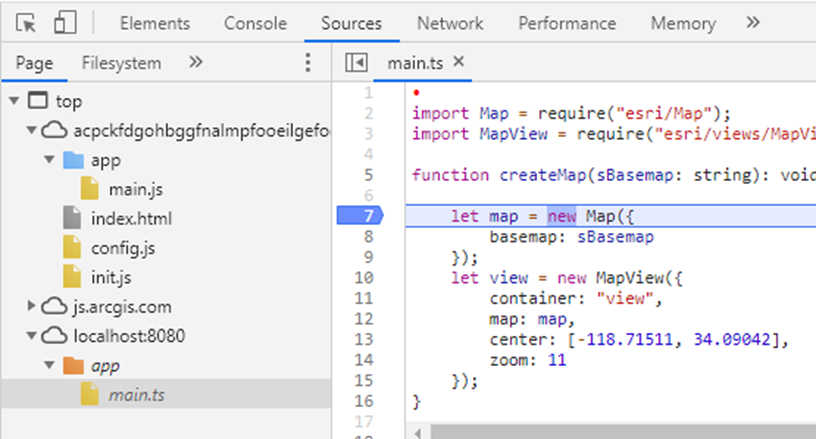

Note that Chrome DevTools will not load TypeScript source maps from within an extension. That's normally not an issue since you can debug the JS files directly. There is a way to debug the TypeScript source, but it involves some extra work. First, set up IIS express to serve up the project folder:

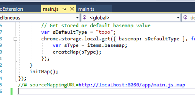

Then, edit the JS files to point to the localhost url:
Now, you can set a breakpoint in a TS file and it will be hit:
The disadvantage of this approach is that you must re-edit the JS files every time you recompile them.

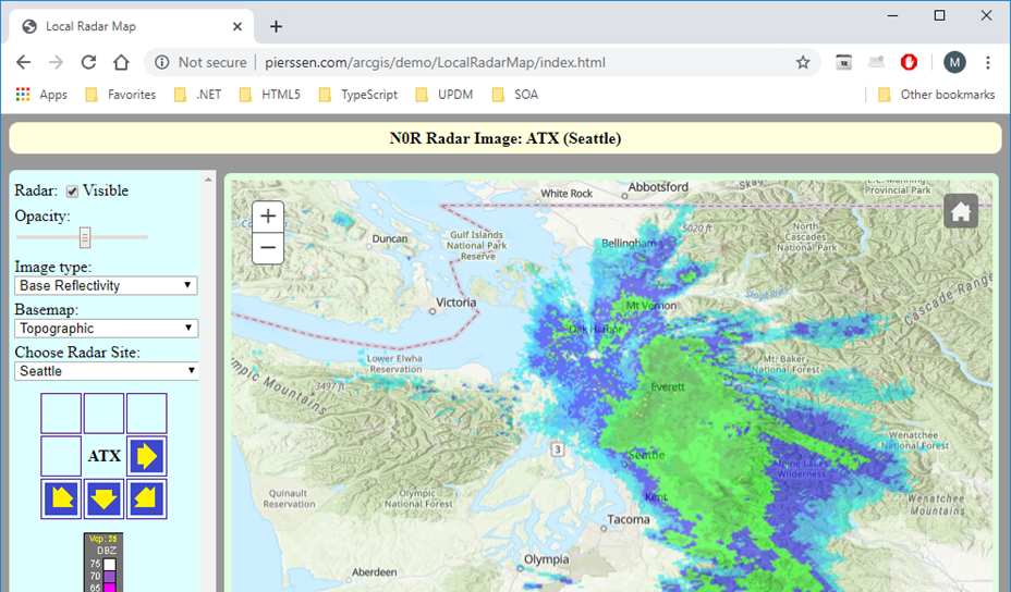

The next demo involves functionality that is available in JSAPI 3.x, but not yet at 4.x. Namely, the ability to grab an image resource and display it as a layer. Here is a web page that displays the latest weather radar imagery:
The latest image is a fixed url, so nothing special needs to be done to reference it. Wouldn't it be cool, however, to display an animated loop of the 10 latest images? But there's a problem.

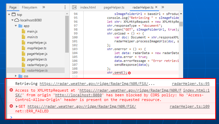

Because the latest set of radar images do not have fixed names, it is necessary to obtain a directory listing to find out what they are. If you set latestOnly to false and run the app, however, you will run into the dreaded CORS policy error:

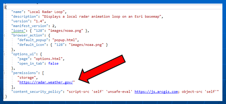

This is where the power of Chrome extensions comes into play. Set isExtension to true, and uncomment the extension-only code (which enables a saved user option), and load the app as an extension. Now you get the desired animation loop!
Note the relevant line in manifest.json which enables the XMLHttpRequest to run without a CORS error:

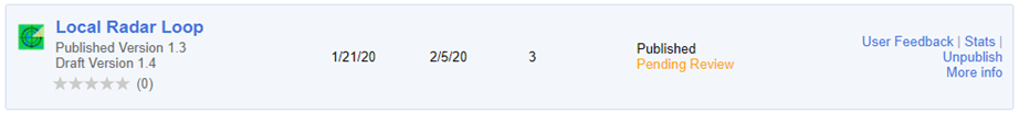

Now, as I pointed out earlier, Chrome extensions are distributed through Chrome Web Store:
There are some advantages to this. For example, updates are automatically distributed to users. You can also create an "invisible" store entry, or publish only to testers. I find that last feature useful for distributing an extension that I created for my personal use only. Other distribution options do exist, which you can read about at this link.
