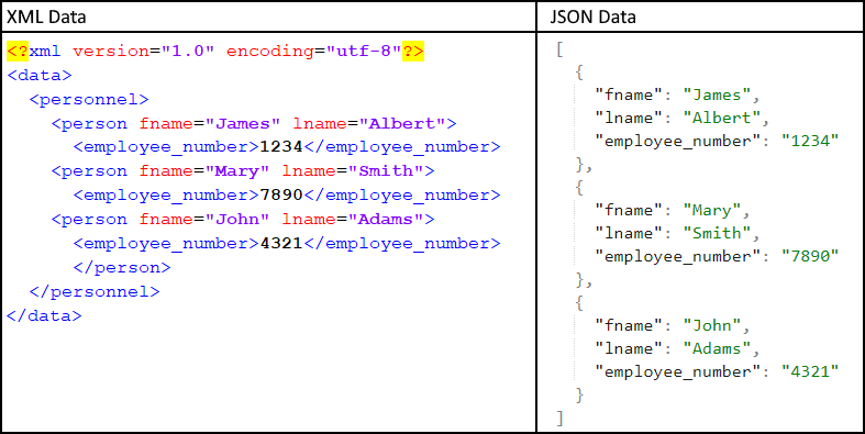

GeoEvent Server uses third party libraries to translate XML it receives to JSON. The JSON adapter is used interpret the data and create event records from the translated data. Because JSON does not support attribute values, all data values in an XML structure must be translated as elements. Consider the following illustration which shows how a block of XML data might be translated to JSON by GeoEvent Server:
Notice the first line of the XML in the XML illustrated above/left. This declares the version and encoding being used which the libraries GeoEvent Server uses to translate the XML to JSON really like seeing as part of the XML data.
Also, notice the JSON to the right of the XML sample organizes each event record's data as separate elements in a JSON array. Data for employee "James Albert (Emp #1234)" is represented in its own set of curl-braces as a single JSON element. There are three employee JSON elements in the array.

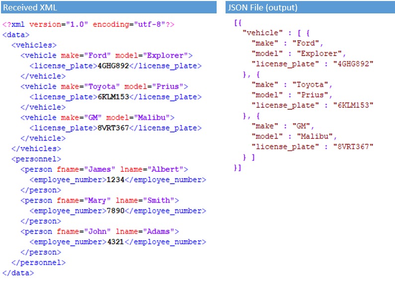

</data>The self-describing nature of the XML makes it apparent to a reader which data elements are which, but an input in GeoEvent Server will have trouble identifying the multiple occurrences of the different data items if the inbound adapter's XML Object Name property is not specified.

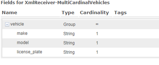

Here is the GeoEvent Definition the inbound adapter generates when its XML Object Name property is left unspecified and the XML data sample above is ingested into GeoEvent Server:
.png)
In testing, the very first time the XML with the combination of "vehicles" and "personnel" was received and written out as JSON to a system text file, I observed only one person and one vehicle written to the output file. Worse yet, without changing the generated GeoEvent Definition or any of the input connector's properties, sending the exact same XML a second time produced an output file with "vehicles" and "personnel" elements that were empty.
The blogJSON Data Structures - Working with Hierarchy and Multicardinality suggests that, at the very least, the cardinality specified by the generated GeoEvent Definition is not correct. The GeoEvent Definition also implies a nesting of groups within groups which won't work once an XML Object Name is specified.

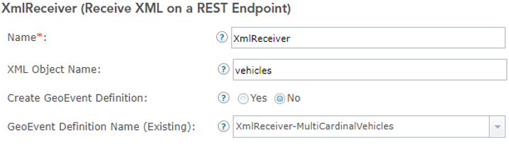

Let's explore how you might work around this issue using the configurable properties available in GeoEvent Server. First, ensure the XML input connector specifies which node in the XML should be treated as the root node by setting the XML Object Name property accordingly as illustrated below:
Second, verify the GeoEvent Definition has the correct cardinality for the data sub-structure beneath the specified root node as illustrated below:
By configuring these above properties accordingly, GeoEvent Server will only consider data within a sub-structure found beneath a "vehicles" root node and should make allowances that the sub-structure may contain more than one "vehicle".

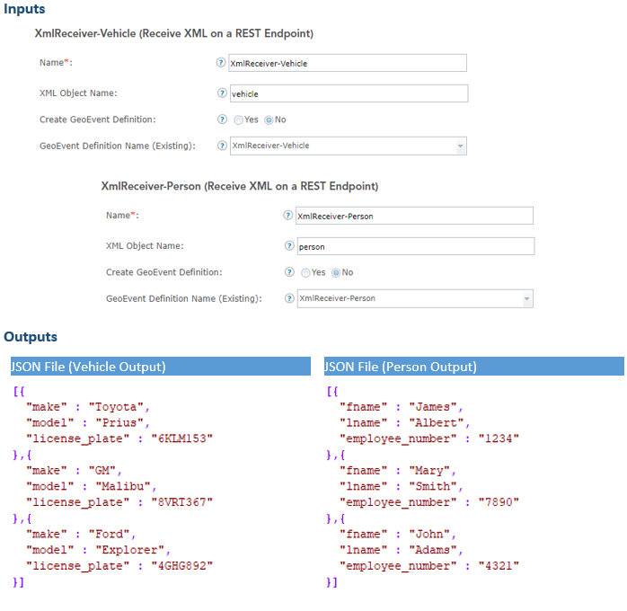

First, the inbound adapter is literally throwing half of the received data away by excluding data from any sub-structure found beneath the "personnel" nodes. This can be addressed by making a copy of the existing Receive XML on a REST Endpoint input and configuring this copy to use "personnel" as its XML Object Name. The copied input should also use a different GeoEvent Definition -- one which specifies "person" as an event attribute with cardinality Many and the attributes of a "person" (rather than a "vehicle") as illustrated below.

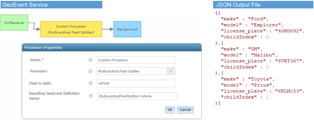

Second, the event record being ingested has multiple vehicles (or people) as items in an array. You'll likely want to process each vehicle (or person) as individual event records. To address this, it's recommended you use a processor available on the ArcGIS GeoEvent Server Gallery, specifically the Multicardinal Field Splitter Processor. There are two different field splitter processors provided in the download, so make sure to use the processor that handles multicardinal data structures.
A Multicardinal Field Splitter Processor, added to a GeoEvent Service illustrated below, will clone event records it receives and split the event record so that each record output has only one vehicle (or person). Notice that each event record output from the Multicardinal Field Splitter Processor includes an index at which the element was found in the original array.
