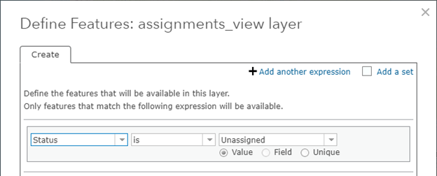

- Define Features to only include features with a status of “Unassigned”

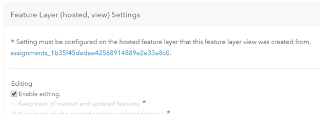

In the Settings tab for the view, enable editing and configure editing permissions in the Feature Layer (hosted, view) Settings section:
- In the Editing section, Enable editing.
- Enable sync if your mobile workers need to create assignments while offline.
- Under What kind of editing is allowed? accept the default of Add, update, and delete features.
- Under What features can editors see? accept the default of Editors can see all features, as that could reduce the creation of duplicate assignments.
- Under What features can editors edit? set Editors can only edit their own features.
Save your changes to the settings.
