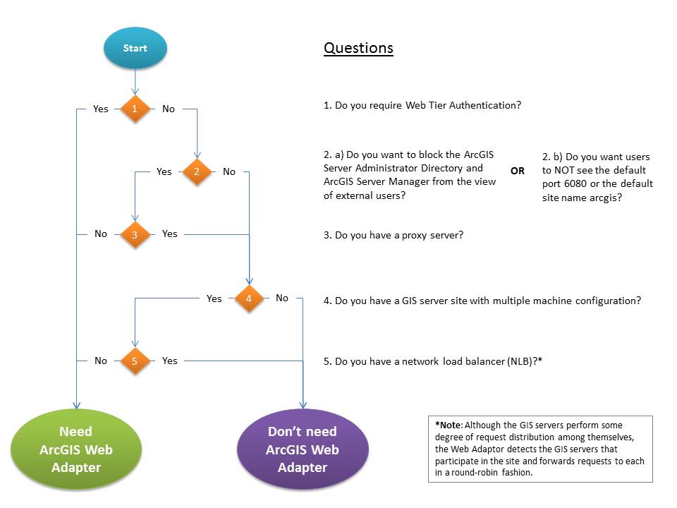

Sinds ArcGIS for Server 10.1 bevat de implementatie de optionele component van de ArcGIS Web Adapter<\/A>. Hoewel de sectie Deployment scenarios<\/A> in de helpdocumentatie goed beschrijft wanneer de webadapter te gebruiken, kan dit spiekbriefje GIS-beheerders en IT-professionals helpen beslissen of de ArcGIS Web Adapter vereist is voor hun GIS-architectuur bij het installeren van ArcGIS for Server 10.1 en hoger.<\/P><\/P><\/P>Een PDF is ook beschikbaar als bijlage voor uw gemak.<\/P><\/BODY><\/HTML>

I am unclear about your question. Web adapter is not essential for web maps - but doesn't hurt either. My diagram help establish if the web adapter is required, but someone can decide to install it regardless.

Correct... if you wish to hide the port 6080 but don't have a proxy server, the web adapter will get you that capability.
Although, I don't believe that being on an intranet has any direct bearing in the decision process. For example, you might state that you don't need to block access of ArcGIS Server Administrative Directory and ArcGIS Server Manager since you are on an intranet. Regardless on the reason (in this case intranet) you still don't need to block access.
Thanks Eric, this is very useful. My interest is when (or if) do you use the web adapter in a intranet. That is, if I do not plan to implement an external facing site. If I understand the diagram correctly, I would implement the web adapter in an intranet if, I want to hide the 6080 port and I do not have a proxy server...correct?
