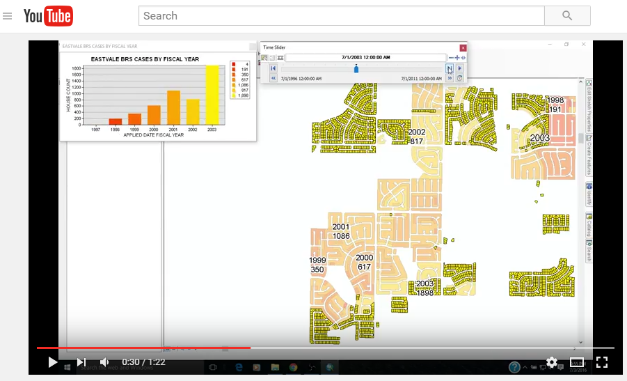

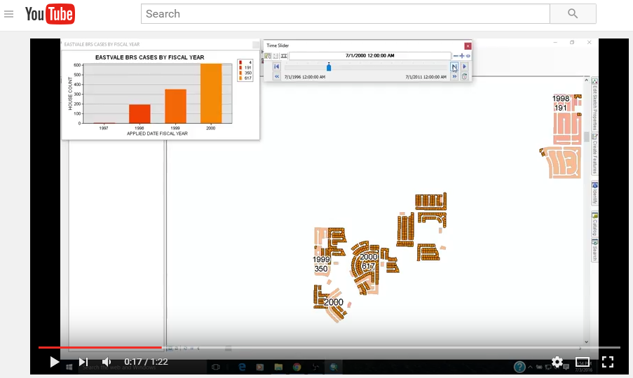

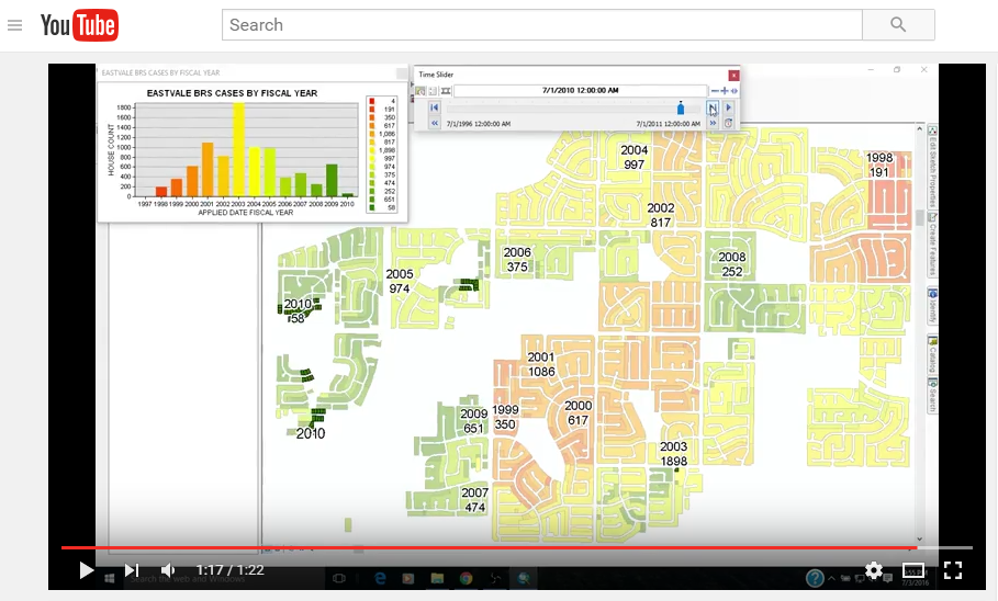

7. A sample time-based animation demo video showing some of what you can do using the calculation.
Here is a link to a YouTube video of a time based animation demo I created that shows the importance of being able to manipulating date fields to create alternative formats and date groupings. This time based animation was only possible after I used my calculation to transform my original Applied_Date field into an Applied_Fiscal_Year Long field for some of my building permits data The new field let me symbolize each Fiscal Year with a distinct color using categorized symbols. The new field also let me Dissolve the permits to get a Count of the Permits in each Fiscal Year. The Dissolve allowed me to create labels on the map showing the counts and a time based graph of the permit activity by Fiscal Year. The Dissolve also dramatically improved the redraw performance over my original data.
Below are a three screenshots from the demo that shows different stages of building permit activity over time using both a time enabled map and a linked bar chart graph.
