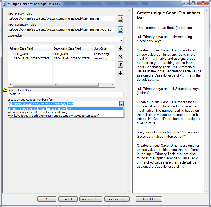

I have created a Python toolbox tool that converts the set of unique key values found in multiple fields that relate two layers/tables into a set of related sequential numbers in a CASE_ID field populated in both layers/tables. This allows a user to create a standard join or relate between the two layers/tables on the CASE_ID field that is equivalent to creating a multi-field join or relate.
This tool was inspired by the ArcInfo Workstation's FREQUENCY command which could optionally add a numeric case field to the source and output that would maintain a single field relationship when the frequency was based on more than one case field. That capability was lost in the Desktop Frequency tool. However, the tool I have created is actually more flexible than what Workstation provided, since it can be applied to any pair of layers/tables, even when the Frequency tool had nothing to do with how they were created or related.
The two zipped python toolboxes attached are designed for ArcGIS 10.3 (Field Match Tools.pyt.zip) and ArcGIS 10.2 (Field Match Tools v10.2.pyt.zip) . The toolboxes should be placed in the "%APPDATA%\ESRI\Desktop10.[3]\ArcToolbox\My Toolboxes" folder to show up in your My Toolbox under ArcCatalog (modify the items in brackets to fit your Desktop version).
I use python lists and itertools to get my sorted unique list of multiple field key values and to generate the sequential numbers associated with each key, but I convert the list into a dictionary prior to running the updateCursor so that I gain the speed or dictionary random access matching when I am writing the Case ID number values back to the data sources. Dictionary key matching is much faster than trying to locate matching items in a list. Here is the interface:
The validation works to make sure that the two input data sources are not the same and that the fields used in the case field list are actually in both sources. The user can choose as many fields as they want to make up their unique multiple field case value keys. The field names do not have to be the same in both data sources. The position of the fields in the list will control the sort priority of the Case Fields (highest priority = top field) and the Sort Order column controls whether the values in each field are sorted in Ascending or Descending order. The sort order of the Case field values controls the Case ID number sequencing. The arrangement of the fields can be different from the field arrangement actually used in the sources.
There are three options for creating sequential numbers in the CASE_ID field output. The first operates like a standard Join, where all unique key values in the Primary table are numbered, but only matching key values in the Secondary table are numbered. All unmatched values in the Secondary table are given a CASE_ID of -1. The second option is an union, where the sequential numbers are based on the complete set of key values in the combination of the Primary and Secondary layers/tables. The third option is an intersection, where only key values found in both layers/tables receive positive sequential numbers. All unmatched values of either table not found in the other table received a CASE_ID of -1.
The 10.3 version tool works the best and has the best features, However, I have provided a 10.2 version, but in order for the tool to work under the limitations of 10.2, the tool has fewer capabilities and a somewhat less intuitive interface. The 10.2 version of the tool does not support controlling the sort order of the fields, so their sequential number values are always based on the use of an ascending order for the field values. To match the fields in the two layers/tables you must click on fields in two lists, but those fields only appear in the separate field string text box when you click somewhere outside of the field lists. The tool sidebar help provides more detail on how to use it.
Here is my code for the 10.3 version of the tool:
