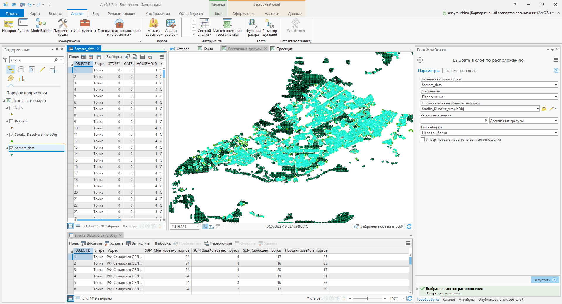

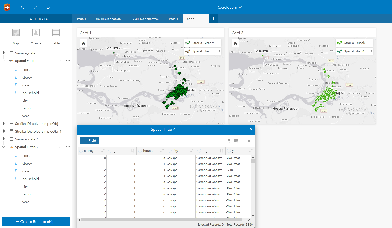

We’ve noticed that the result of this tool in Insigts and in Arcgis Pro or ArcGIS Online differs. The source data of both layers is in decimal degrees - WGS84.
ArcGIS Pro returns 3860 intersecting features, Insights returns the same result only if data published as service in decimal degrees (WGS 84).
If service with the same data is published in Web Mercator Auxiliary Sphere – it returns 1581 feature.

I couldn't understand why I get so few coincident features in the result and began experimenting with my data. Tried to find coincident features in Pro, then published new services in WGS84, without on the fly reprojecting in Pro to Web Mercator and applied spatial filter in the Insights to the new published layers.
