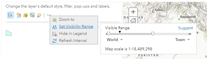

I am trying to programmatically change the Visibility Range of layers published to the Enterprise Portal. It is possible to do this manually (as shown below), yet that is not the preferred option as I have to adjust a large amount of layers.
