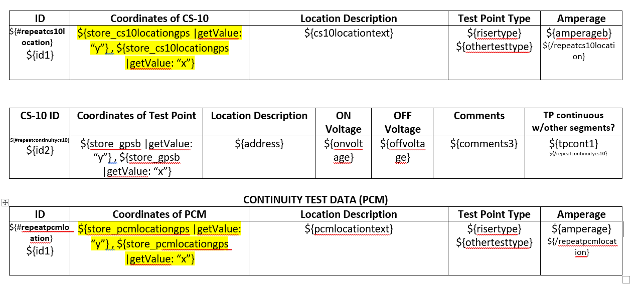

I am trying to have my report save the x.y coordinates of a geopoint in my survey. I have multiple excel tables containing my repeats. Most of my repeats have geopoints in them and they are extracting the x.y values fine. All the other fields in the repeats return values, which makes me think its not a problem with the begin/end repeat and closing that.
I am just stuck on 2 and I can not figure out why. I've attached the report and survey for review.

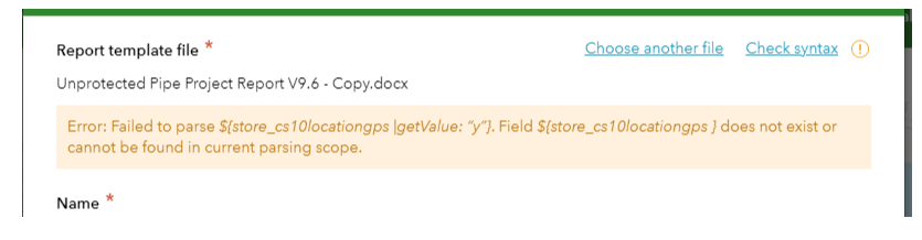

Error:

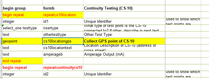

Snippet of survey:

By looking into your XLSForm and the report template, it seems the field name store_cs10locationgps is not correct and cannot be found in your XLSForm. Would you mind using the correct field name cs10locationgps and try again? Please see the attached image for details.
