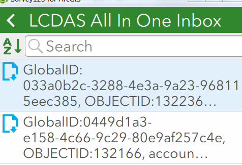

Is there a way to specify the fields to display when listing the surveys in the inbox and labeling them on the inbox map?
As shown in these screenshots, it appears to use the GlobalId and OBJECTID fields first and then the rest of the fields in alphabetical order both for the list and labeling. If I could set it up to use the display field or to specify the fields that would help.
