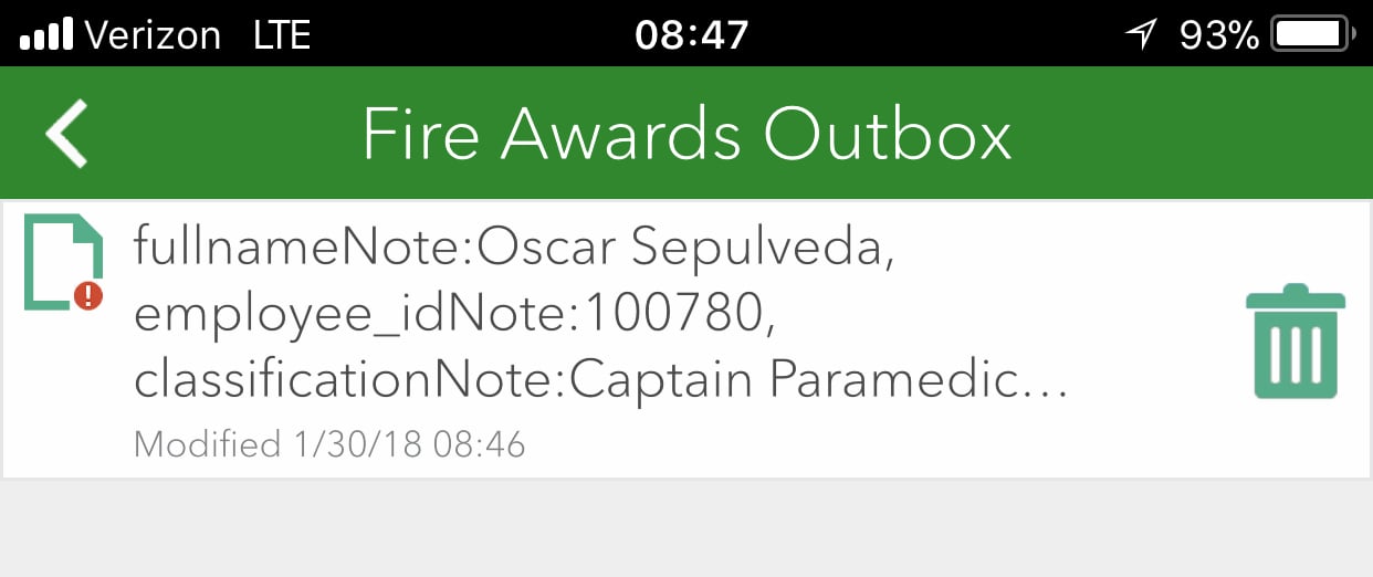

I have gone over my form numerous times and tried the completed survey on other devices without any luck.
The survey will send an email successfully. But it fails to 'Send Now' to finalize the process. I do not receive any error messages, the outbox only shows a red exclamation point (shown below).
Form is attached.

Thank you Brandon,
It does appear just increasing the fieldlength for all of the rows fixed the issue. Yet, why didn't I receive an "Error Code" only the symbol?
Good to hear that increasing the fieldLength's resolved the issue. I suspect it was due to the fact that you had an inputMask of (000) 000-000 and a fieldLength of 10. Each of the parentheses and the dash would also count as a character. As to the error message, I was able to observe it by using the AppStudio Console in order to troubleshoot. The steps that can be used to do this are listed here...
Troubleshoot—Survey123 for ArcGIS | ArcGIS
Hopefully, we will be able to prompt an error dialogue for this issue in the future.
Just as added info we encountered the same Red Exclamation point issue. In our case a user1 had completed a survey, then the record was deleted by them from the feature service. User2 added a new record back that used the same identification (Work Order) number. User1 opened the old survey from his inbox on his device, made changes and attempted to repost. But technically that record didn't exist anymore. User1 could submit new entries but not update/edit his (since deleted) original record....
