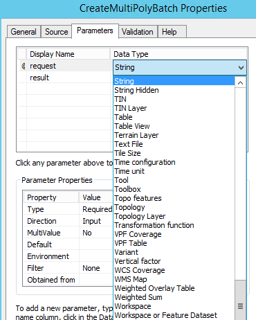

I then need to pass this to a GP service I set up with an input parameter called '"Request"
Question:
When setting up the parameters do I select "STRING" ???
