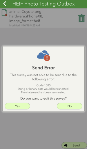

- One image taken with native iOS camera set to HEIF format and attached to the form using the photo library attachment in the form - Fail see below
Attaching a photo that I know to be taken in HEIF caused this error:
