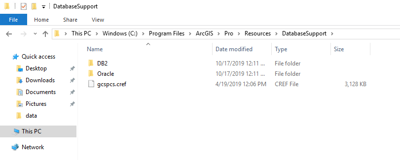

Now I would like to initialize geodatabases in PostgreSQL following below instruction but looks like st_geometry.dll is missing in my installation directory
Tutorial: Get started with geodatabases in PostgreSQL—Manage geodatabases in PostgreSQL | ArcGIS Desktop
Where can I get st_geometry.dll for trial license ?

You may not find this file either from ArcGIS Pro or Postgres. You have to download ArcGIS Pro Database Support from organization account. Postgres support file is not provided for free.
