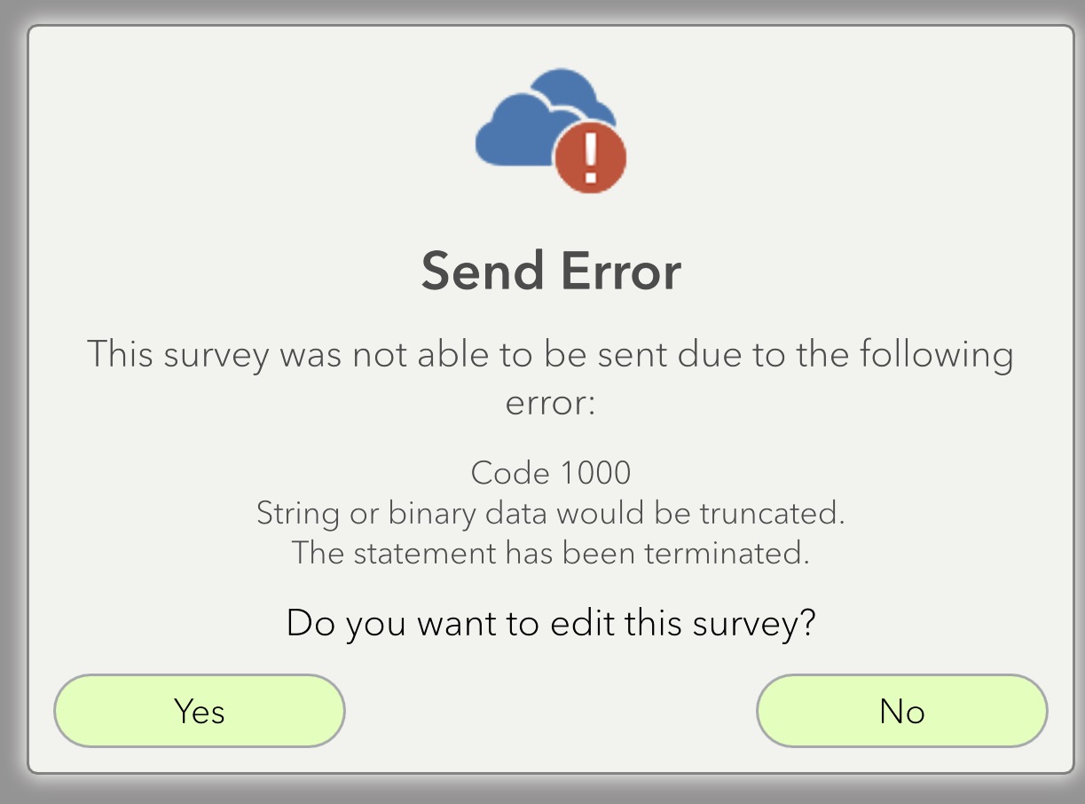

I have repeatedly gone over my form and all of my field lengths are set accordingly (checked with =LEN), yet I continue to receive a 'Send Error' when I try to complete the form. The form works beautifully in 'Connect' AND after publishing it sends the email, but cannot upload to AGOL.
I have attached my form to assist.
Hi Oscar. Just a guess here: the problem may be caused by any of your calculations, which could be generating a string that exceeds the max length of their corresponding text field. I noticed you set the length of many fields to 1500, but this may not be enough.
Well, I went big and changed 1500 to 20,000 and it still wont send.... Unless of course the problem is with one of the other defined 'fieldlengths' or one that is set at the default
Hi Oscar,
I'd look at the hidden and note questions where you assemble the e-mail. A sample I did with your form created an e-mail of 404 characters, above the default 255.
