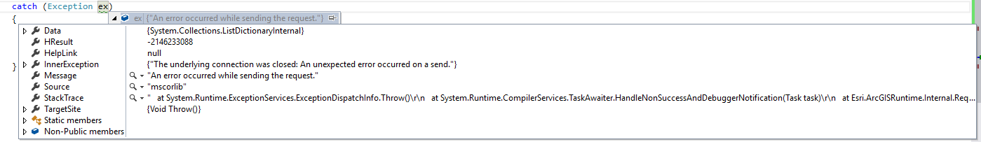

await myWmtsService.LoadAsync();
the LoadAsync() throws and exception
I've tried various formats of the URL including ?request=GetCapabilities&service=WMTS and a different service but get the same error. Please advise.

We are using .Net 4.6.2 and the WmtsLayer class and WmtsService class appear to handle TLS protocol a bit different than other map layer types. We worked around this issue by specifying a TLS protocol.
in code
System.Net.ServicePointManager.SecurityProtocol = System.Net.SecurityProtocolType.Tls11| System.Net.SecurityProtocolType.Tls12;
or in the App.config
<runtime>
<AppContextSwitchOverrides value="Switch.System.ServiceModel.DisableUsingServicePointManagerSecurityProtocols=false;Switch.System.Net.DontEnableSchUseStrongCrypto=false" />
</runtime>
