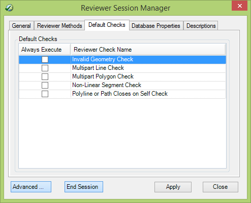

I have several features that I have queried out in my RBJ files that are returned from an invalid geometry data reviewer check. These features do have invalid geometry, but it is intentional and I want them filtered out of the reviewer results table.
When I run the RBJ files inside of a review session in ArcMap 10.3.1, 0 results are returned which is expected. This is after I turn off the Invalid Geometry Check in the Default Checks tab in the Reviewer Session Manager.
I cannot find any documentation on how to turn this off when creating a python file from it, as the same RBJ file is referenced in my script but it still returns invalid geometry that I do not want to be returned.
