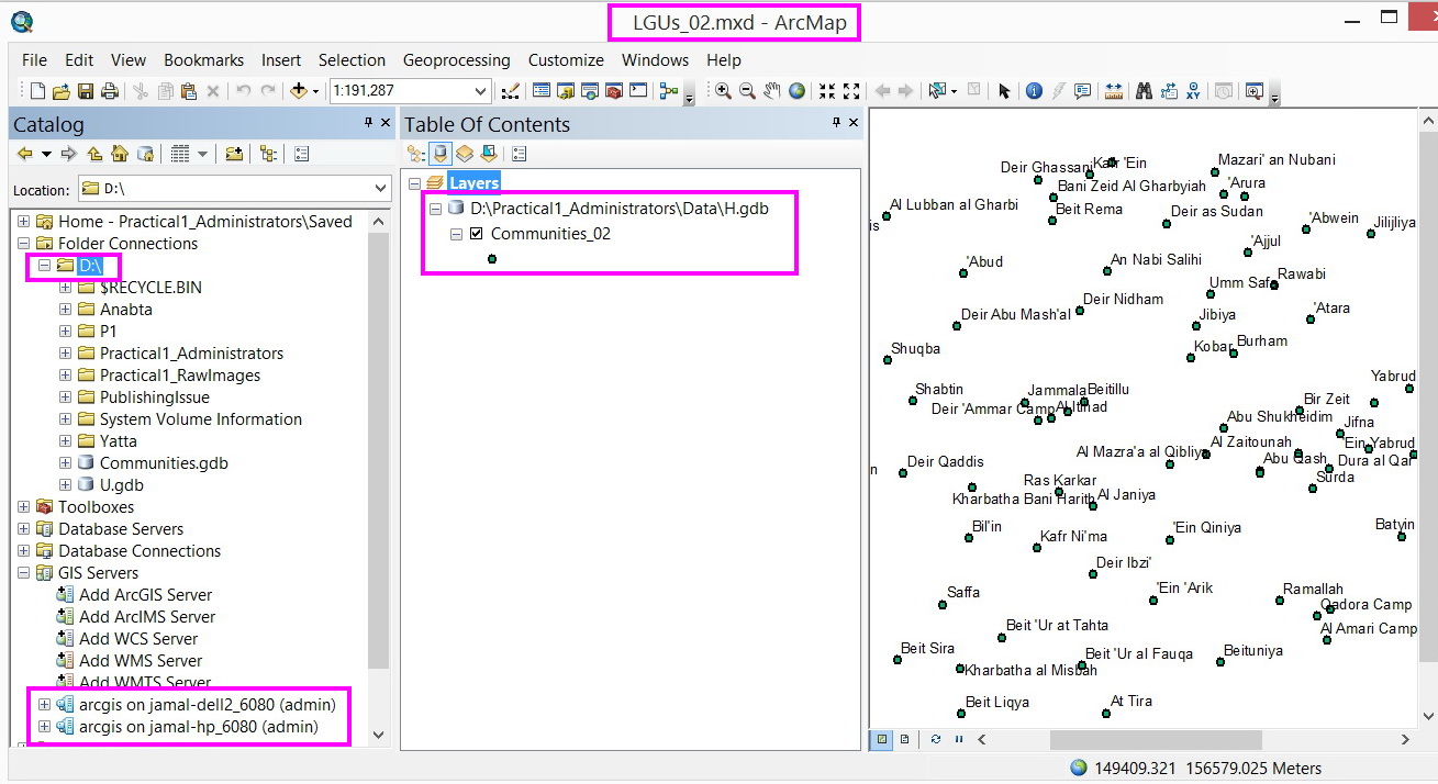

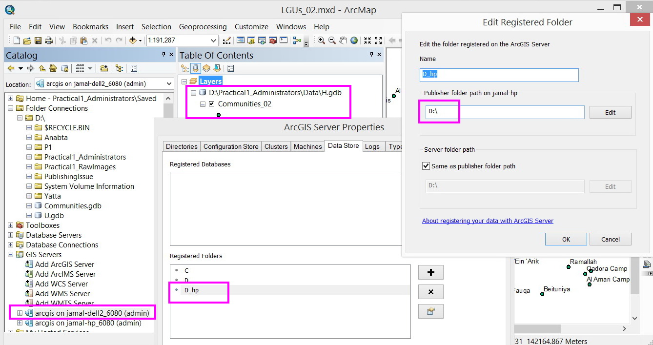

- The data is saved in “jamal-hp” machine (D drive)
- This D drive is registered in the ArcGIS Server deployed in the “jamal-dell2” machine

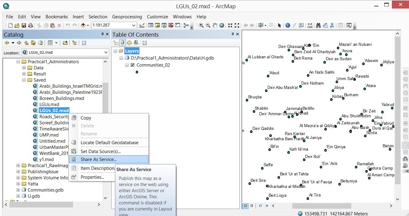

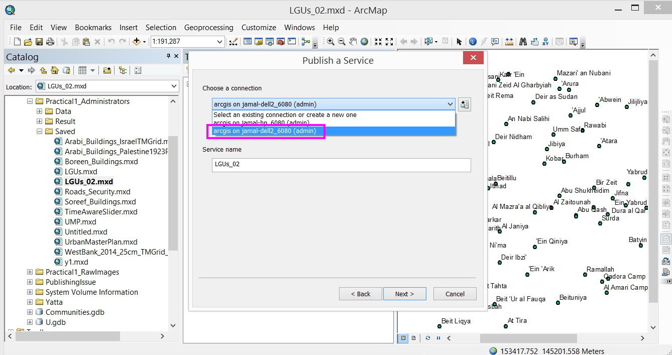

- An mxd file that contains some of this data is required to be published in the “jamal-dell2” machine.

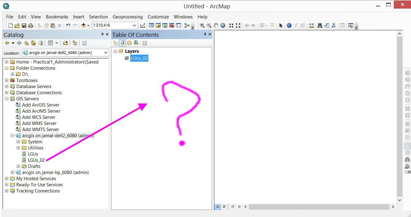

- This mxd is published successfully. Now the service can’t be displayed.
What might be the issue here?
However, if the D drive is not registered and the data is allowed to be copied, the service is properly displayed.
How can one still publish in other service WITHOUT the need to copy the data? I assume that this issue is related to configuration at the level of network (connection).
