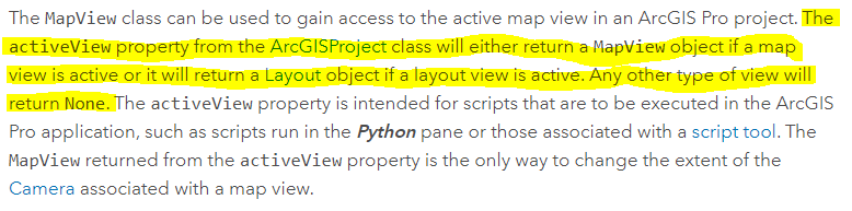

I'm stumped. The following documentation says activeView will return the active MapView or Layout. I've searched high and low trying to find code to use which will tell me If the "active view" is a map or a layout but am having zero luck.
Any insight appreciated.
Thanks!
MapView—ArcGIS Pro | Documentation
