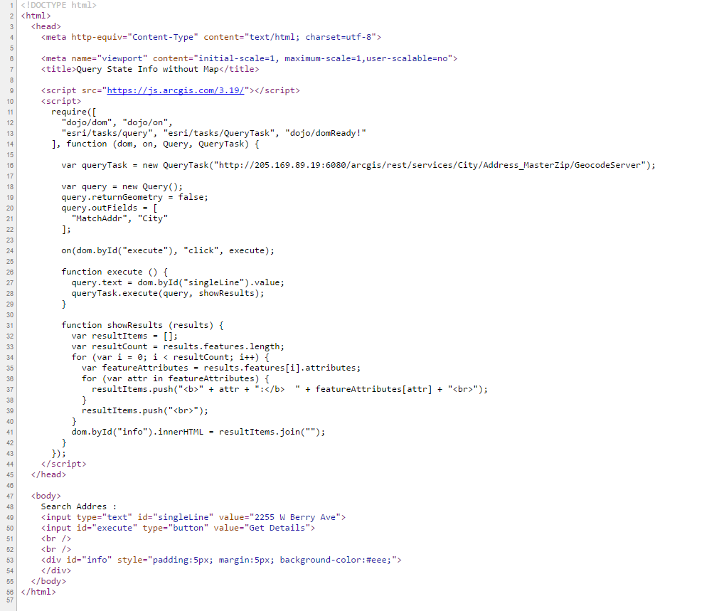

I am trying to build a stand alone widget that will allow a user to input an address. The address will then get pushed through a custom locator and specific fields will then be displayed based on the address entered.
I am trying to adjust the Query data without a map but I am open to other suggestions.
I have attached the html and here is my code:
Why don't you just use the Search widget (Search | API Reference | ArcGIS API for JavaScript 3.19 ) and specify your GeocodeServer as the locator for the default search source?
