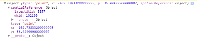

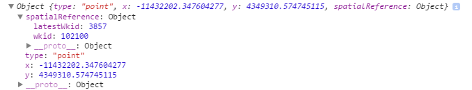

On the 10.3 server the search works correctly returning a point feature that is in web mercator in web mercator coordinates(there must be some conversion going on in the background):
On the 10.3.1 server the coordinates are returned in geographic (4326) but the spatial reference is set to web mercator and the search result shows up on the map off the coast of Africa instead of Texas where it is supposed to:
Does anyone have any idea what might be going on here?
