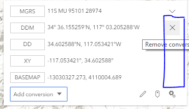

I am looking at the CoordinateConversion widget for the current 4.10 release. I am finding some unexpected behavior when adding and removing different coordinate systems. It seems the 'remove conversion' button does not remove the expected coordinate system format. It either removes the first or last coordinate system format (depending on top or bottom ui placement) regardless of which button I click. Is this expected behavior?
Have you tested 4.11 to see if this is already fixed? To do that just change the API urls to 4.11.
Thanks for the reply. I just tested this in 4.11, but no luck. The remove buttons still don't seem to be correctly linked.
Then you need to report this to esri tech support so that a bug can be filed.
