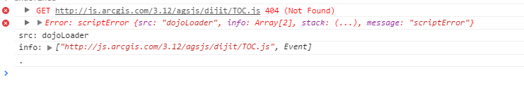

is the TOC not working anymore in 3.12 API?
<script src="http://js.arcgis.com/3.12/"></script>
<script type="text/javascript">
var djConfig = {
parseOnLoad: true,
packages: [{
"name": "agsjs",
"location": "http://gmaps-utility-gis.googlecode.com/svn/tags/agsjs/latest/build/agsjs"
</script>
it worked for 3.11 and now in 3.12 just getting this error even if I access the file locally. the reference is set to: "agsjs/dijit/TOC"
This is the code that Nianwei Liu uses on their site with 3.12 API
<script type="text/javascript"> // helpful for understanding dojoConfig.packages vs. dojoConfig.paths: // http://www.sitepen.com/blog/2013/06/20/dojo-faq-what-is-the-difference-packages-vs-paths-vs-aliases/ var dojoConfig = { paths: { //if you want to host on your own server, download and put in folders then use path like: agsjs: location.pathname.replace(/\/[^/]+$/, '') + '/../src/agsjs' } }; </script>
or if you are not hosting it locally then use this:
<script type="text/javascript"> // helpful for understanding dojoConfig.packages vs. dojoConfig.paths: // http://www.sitepen.com/blog/2013/06/20/dojo-faq-what-is-the-difference-packages-vs-paths-vs-aliases/ var dojoConfig = { paths: { //if you want to host on your own server, download and put in folders then use path like: agsjs: "http://gmaps-utility-gis.googlecode.com/svn/tags/agsjs/latest/build/agsjs" } }; </script>
Got it to work,
Thank y' all
Richard,
The TOC dijit does not come from esri and thus the error you are seeing. You are trying to load the toc from http://js.argis.com/3.12/agsjs/dijit/TOC.js and it does not exist at that location as this is a third party dijit.
