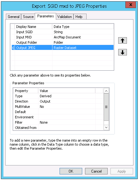

I've created a python script that I've published as a geoprocessing service. The python script takes as input an SGID, a unique id associated with a land parcel, landuse indicating crop fields irrigated and non-irrigated. The map is exported to a jpeg image for each SGID supplied to the python script. I've added arcpy.SetParameter(3, output_jpeg) at line 52 to return the output jpeg to the geoprocessing service.

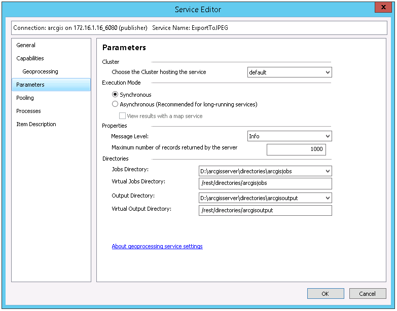

I then ran the python script locally, in order to publish the result as a geoprocessing service.

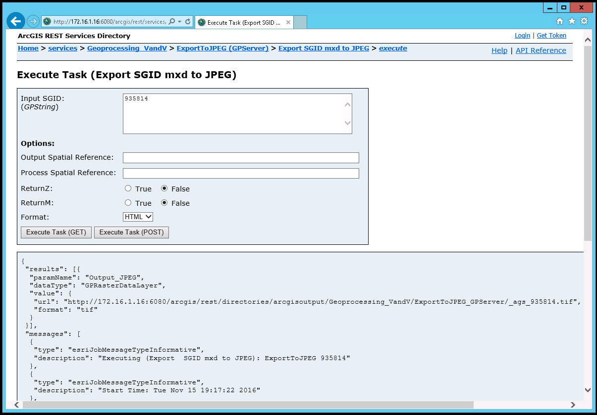

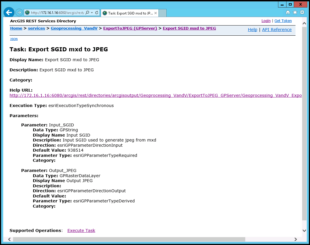

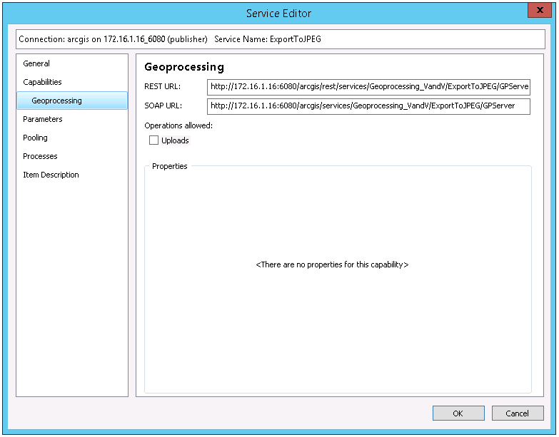

I copied the REST URL: http://172.16.1.16:6080/arcgis/rest/services/Geoprocessing_VandV/ExportToJPEG/GPServer into my browser in order to execute it.
The output raster returned is renamed adding "_ags_" prefix, and saved out as TIFF format. and if I rerun the geoprocessing service for the same SGID, it doesn't overwrite the raster but adds a suffix "1".
<SPAN class="punctuation token">{</SPAN>
<SPAN class="string token">"results"</SPAN><SPAN class="punctuation token">:</SPAN> <SPAN class="punctuation token">[</SPAN><SPAN class="punctuation token">{</SPAN>
<SPAN class="string token">"paramName"</SPAN><SPAN class="punctuation token">:</SPAN> <SPAN class="string token">"Output_JPEG"</SPAN><SPAN class="punctuation token">,</SPAN>
<SPAN class="string token">"dataType"</SPAN><SPAN class="punctuation token">:</SPAN> <SPAN class="string token">"GPRasterDataLayer"</SPAN><SPAN class="punctuation token">,</SPAN>
<SPAN class="string token">"value"</SPAN><SPAN class="punctuation token">:</SPAN> <SPAN class="punctuation token">{</SPAN>
<SPAN class="string token">"url"</SPAN><SPAN class="punctuation token">:</SPAN> <SPAN class="string token"><SPAN>"</SPAN><A class="jive-link-external-small" href="https://community.esri.com/external-link.jspa?url=http%3A%2F%2F172.16.1.16%3A6080%2Farcgis%2Frest%2Fdirectories%2Farcgisoutput%2FGeoprocessing_VandV%2FExportToJPEG_GPServer%2F_ags_935814.tif" target="_blank">http://172.16.1.16:6080/arcgis/rest/directories/arcgisoutput/Geoprocessing_VandV/ExportToJPEG_GPServer/_ags_935814.tif</A><SPAN>"</SPAN></SPAN><SPAN class="punctuation token">,</SPAN>
<SPAN class="string token">"format"</SPAN><SPAN class="punctuation token">:</SPAN> <SPAN class="string token">"tif"</SPAN>
<SPAN class="punctuation token">}</SPAN>
<SPAN class="line-numbers-rows"><SPAN></SPAN><SPAN></SPAN><SPAN></SPAN><SPAN></SPAN><SPAN></SPAN><SPAN></SPAN><SPAN></SPAN><SPAN></SPAN><SPAN></SPAN></SPAN>Is there a way to prevent this from happening. I need the raster to be jpeg's not tiff's and the name cant' be changed it needs to match the SGID. The rasters also need to be overwritten if they exist as the data is constantly being updated so the jpegs need to reflect the updates each time they are rerun as they are being imbeded into a SSRS report that is being sent out to the owners of the land parcels.
