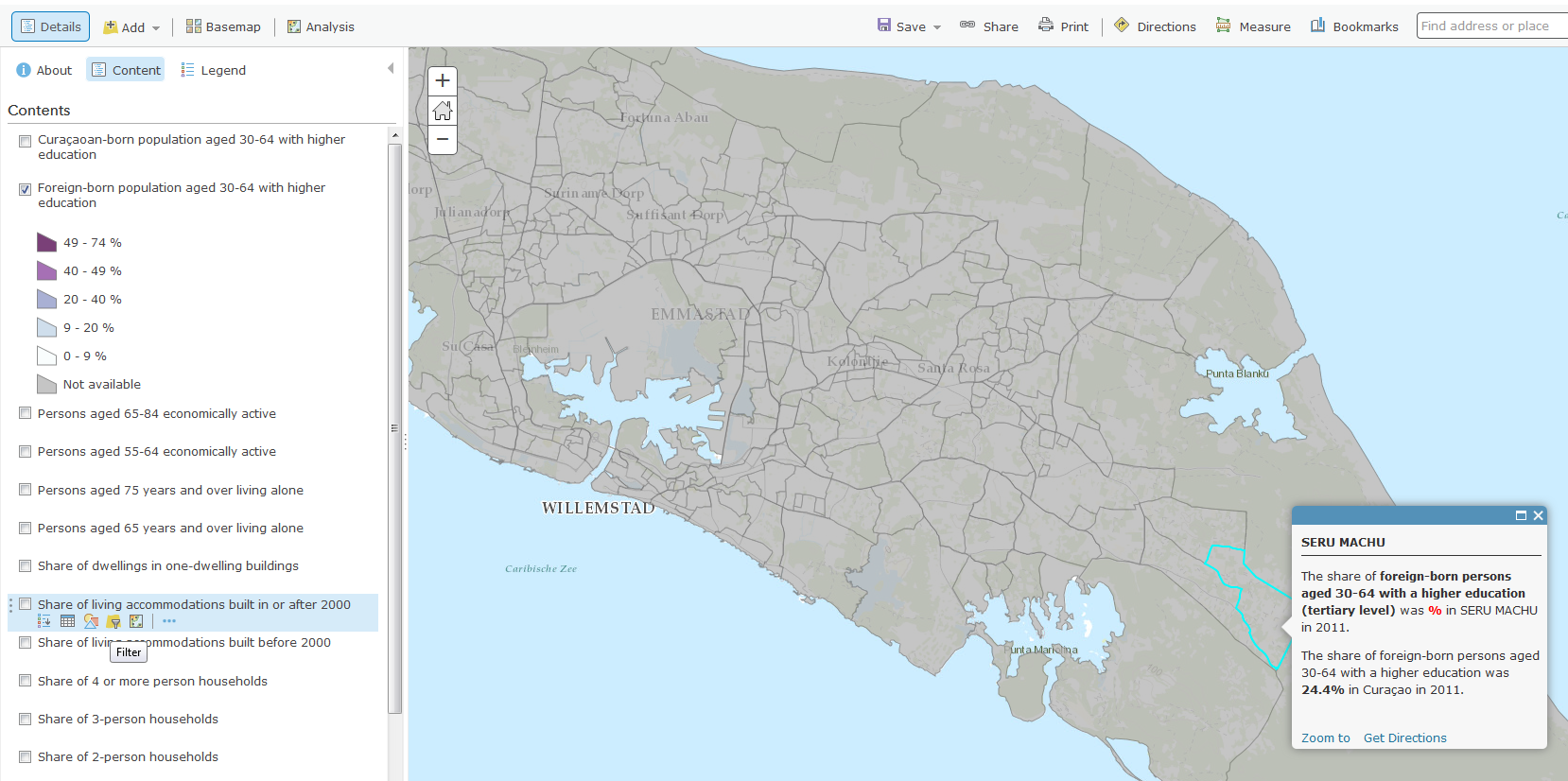

Initially, sharing the layers as web layers (features, not tiles) copied everything to AGOL, except the pop-ups. But when I try to share my layers now the symbology appears erroneous in AGOL; all of the neighbourhoods seem to be in the 'Not available' class (see attachment for larger image):
The legend and the pop-ups however do appear in my web layers, but don't seem to be related to the underlying attribute table: the data value in the pop-up that should be read from the attribute table is missing in the pop-up. Likewise, the customized text from my pop-up is nowhere to be found in the 'configure pop-up' option in AGOL.
