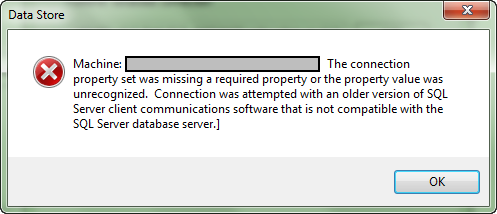

I am trying to register a SQL DB with my server, but getting the following error:
The connection property set was missing a required property or the property value was unrecognized. Connection was attempted with an older version of SQL Server client communications software that is not compatible with the SQL Server database server.

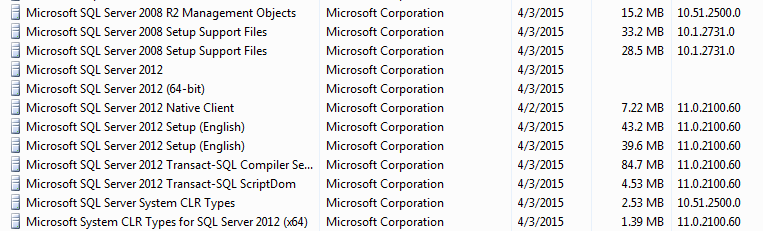

This is similar to Connection was attempted with an older version of SQL Server client communications, but I am pretty sure I have the same versions. Here are the SQL Server applications installed:
Installations:
ArcGIS for Desktop 10.3
ArcGIS for Server 10.3
SQL Server 2012

Make sure the native client is the SQLServer2012_NativeClient_64 version for the 64-bit ArcGIS Server client. ArcGIS Desktop will need the 32-bit version. The programs and features list won't indicate 64 or 32 bit. You have to find the .msi file used to install the client to see which version is installed.

This error can occur if your ArcGIS Server Service Account doesn't have access to your Geodatabase.
Using Database Authentication got me past this error, but now I am getting a new error:
