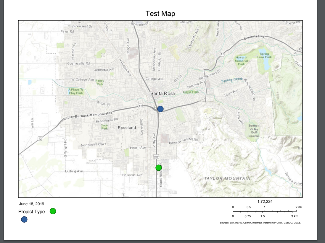

I'm using the ARCGIS JS API (4.11) to create a map with points. I've added a Print Widget to the map and when I generate the printable pdf, the legend does not show with labels. When I use an earlier version of the api (4.06) I see "Override 1", "Override 2", etc. as the legend labels.
I've even tried using the utility.arggisonline.com print service (only as a test), but get the same problem. Any ideas on why the print widget doesn't show labels but the map does? (codepen link below)

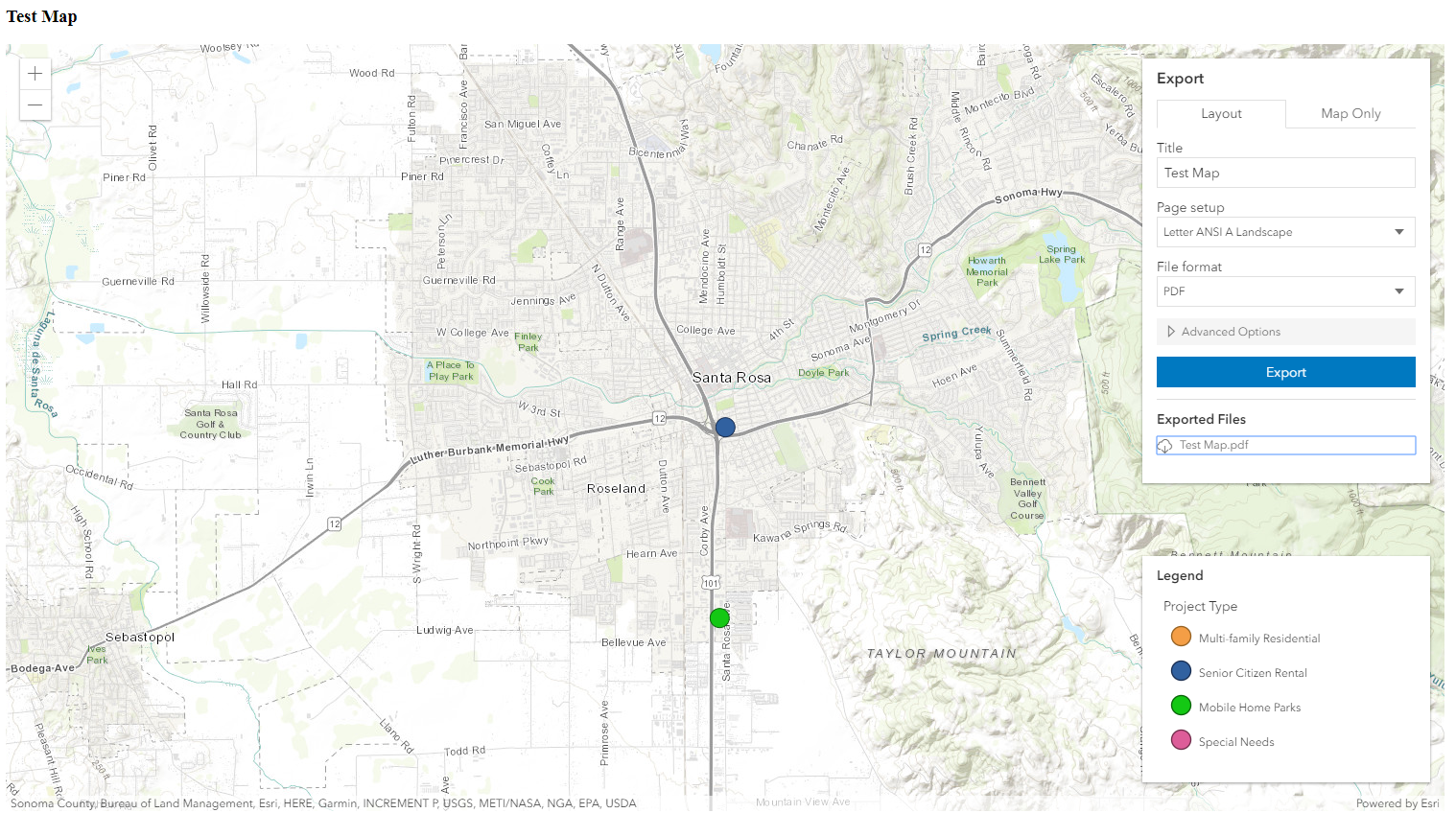

The map:
The exported pdf using the Print widget - no labels for the Legend.
Here is a code pen illustrating the problem. I've tried to distill this down to a fairly simple small'ish example (with hardcoded json data as the source data).
Anyone see any obvious problems? (note: to view the pdf, you might have to right click it and save it locally after you click export.)
Here's the code pen link: https://codepen.io/snmoore/pen/XLjzMb
