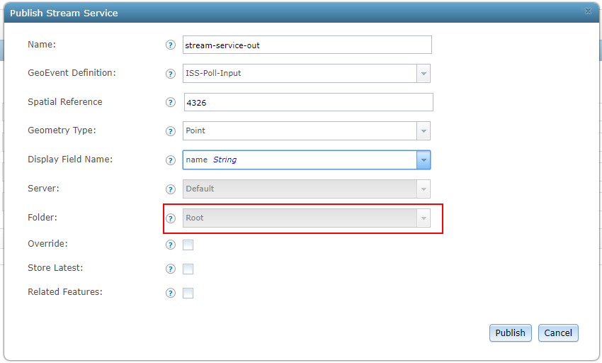

I'm trying to add a "Send Features to a Stream Service" output in GeoEvent 10.6.1 to a folder.
I choose "Default" Server which actually points to a federated Portal. On Portal, to structure content better, I use folders. Unfortunately the folder dropdown is grayed out.
Even when I try to take a Server which represents the local ArcGIS Server I cannot choose a folder.
In my case it would be sufficient, to put the created PortalItem into a subfolder (and leave StreamServices all in the root folder), but when I move the PortalItem to a subfolder the StreamService isn't accessible any longer after a service restart.
Has anybody managed to use folders for StreamService in a federated environment? Or am I doing something wrong?
