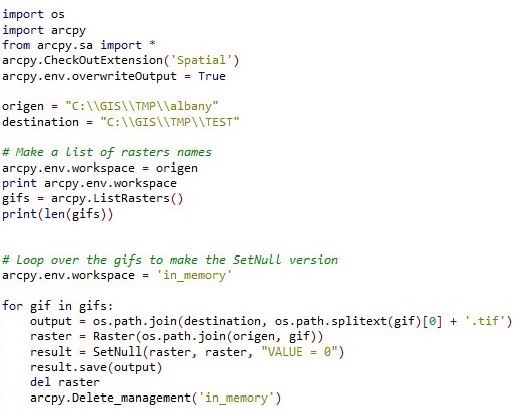

Then I checked what happened with a simple script that tries to Set Null a large number of rasters in a folder (5900) and save the result in another folder.
Now, SetNull() fails after near 1500 loops, whatever the modification I tried, and the error is saving the result (ERROR: 010240). However the same script works fine in Windows 7 and with ArcGIS 10.3.1. I think this is not an issue exclusive of SetNull(), and can occur with other functions that creates temporary data.
