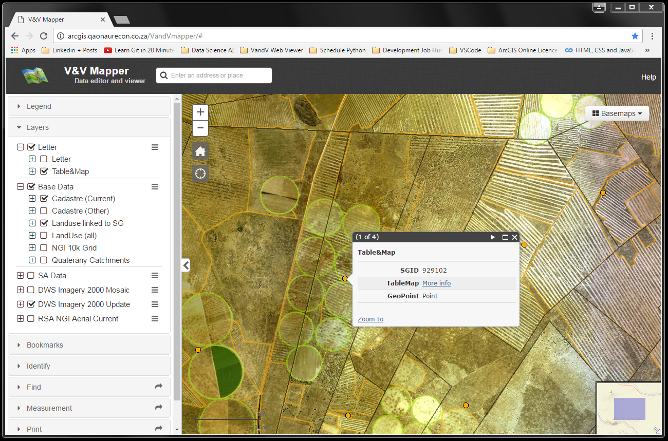

We currently have the following CMV viewer (V&V Mapper) that we are using. Our SQL Dev has written a SQL SSRS report that is triggered when the following link (Tablemap) below is selected.
TableMap: MoreInfo

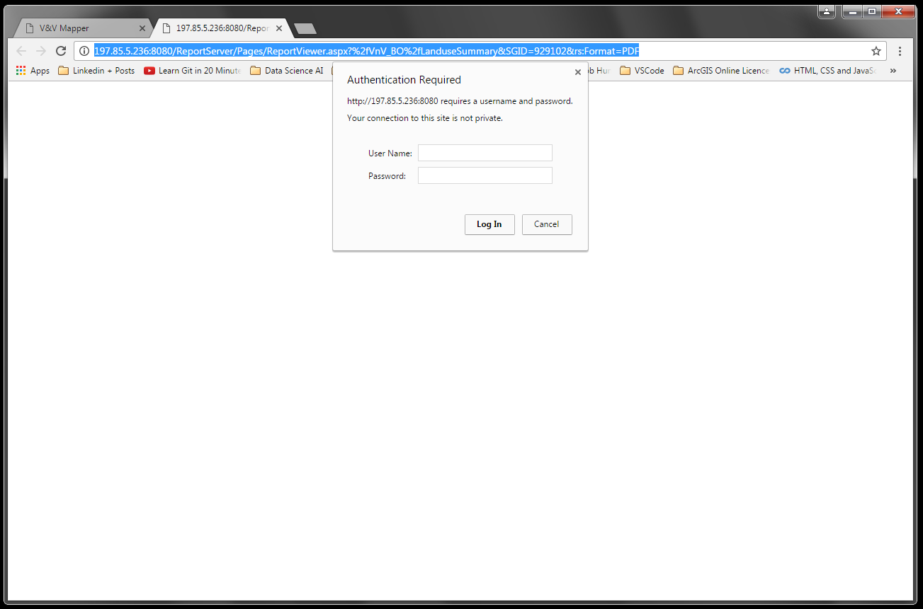

SSRS URL: "http://197.85.5.236:8080/ReportServer/Pages/ReportViewer.aspx?%2fVnV_BO%2fLanduseSummary&SGID=929102&rs:Format=PDF"
I've attached my python script below that as an input argument accepts the SSRS Url and extracts the SGID value using Python Urlparse module (i.e. I'm still using Python 2.7.8 and ArcGIS 10.3.1).
