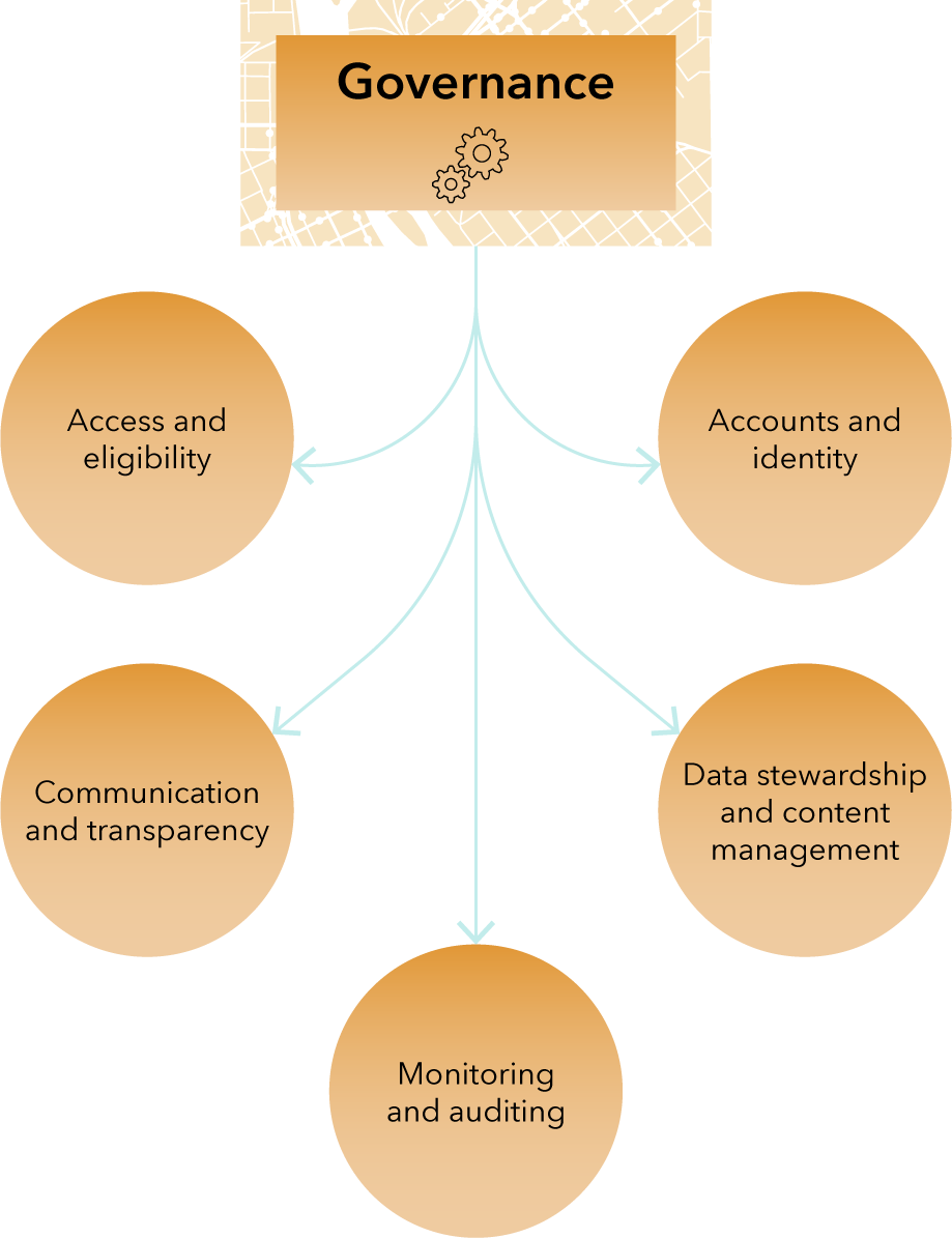

What is governed
Governance defines what decisions are made and what areas are subject to institutional policy. For ArcGIS in higher education, governance typically focuses on a set of core decisions that together support responsible, scalable use of the system.
These decision areas are not specific technologies or configurations. Chapter 3 describes how these governance decisions are implemented operationally, while Chapter 4 describes how they are communicated and reinforced.
Access and eligibility
Governance establishes who is eligible to access ArcGIS and how access is granted and revoked. This includes the following:
- Eligibility criteria for students, faculty, staff, and affiliates
- Alignment with institutional identity and access management systems
- Consideration of lifecycle events such as enrollment changes, graduation, or separation
Clear access policies help ensure that ArcGIS remains available to authorized users while reducing administrative burden and risk.
Accounts and identity
Account governance defines how user identities are managed within ArcGIS, including the following:
- Account creation and lifecycle management
- Privacy and security considerations for user information
- Alignment with institutional policies governing accounts for other enterprise systems
These decisions directly inform the system configuration decisions you will make and support scalable onboarding and offboarding.
Data stewardship and content management
In the context of ArcGIS, content includes data, services, maps, applications, and other items created or shared within the system. Governance establishes expectations for the following:
- Authority and ownership of content
- Retention, archiving, and disposal of content
- Storage limits and responsible use of shared resources
- Metadata and documentation standards
Data stewardship is especially important in higher education, where content may be created by students, faculty, researchers, and staff with varying account lifecycles and institutional obligations.
Communication and transparency
Governance defines how expectations, responsibilities, and policies are communicated to users. This includes the following:
- Publishing governance policies and guidelines
- Educating users about their responsibilities
- Communicating changes, updates, and lifecycle events
Chapter 4 expands on this domain by describing specific communication strategies and engagement practices.
Monitoring and auditing
Governance also establishes expectations for monitoring ArcGIS usage to ensure system health and sustainability. This includes the following:
- Periodically reviewing usage patterns
- Monitoring of storage, credits, and activity
- Using monitoring insights to inform governance decisions
Monitoring is a mechanism for understanding system health, tracking growth, demonstrating value, and planning for future needs. It is not punitive but rather a means to maintain awareness and address issues before they become problems.

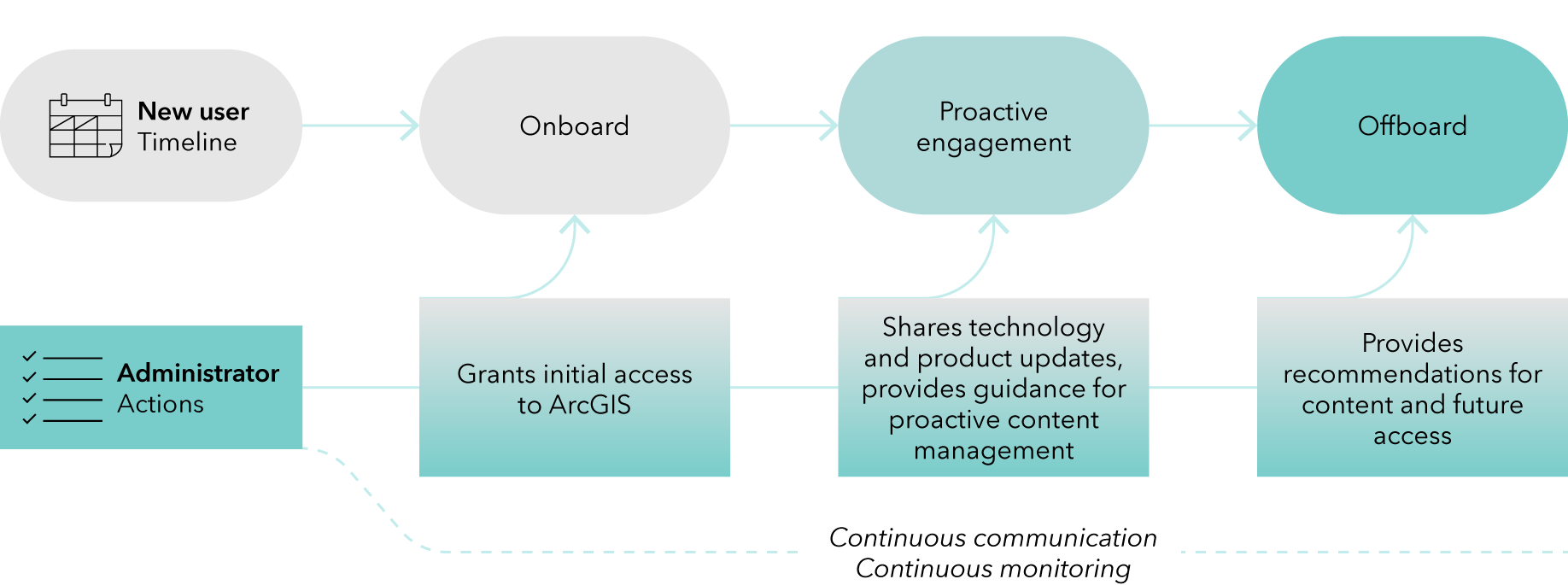

Governance across the user lifecycle
Governance in higher education must account for the dynamic nature of the academic environment. Users regularly join, change roles, collaborate, and depart. Governance across the user lifecycle ensures that access, content, and responsibilities are managed consistently at each stage.
The lifecycle perspective introduced here informs both system implementation (Chapter 3) and engagement practices (Chapter 4).
Onboarding
Governance begins with onboarding. As users gain access to ArcGIS, governance policies define who is eligible for access, what level of access is appropriate, and what responsibilities users assume when using ArcGIS.
Effective onboarding sets expectations early, reduces confusion, and minimizes the need for manual intervention by administrators. Automated and scalable onboarding practices help enforce governance consistently as adoption grows.
Active use
During active use, governance focuses on responsible creation and management of content, appropriate sharing and collaboration, and ongoing stewardship of data, maps, applications, and groups.
Governance during this stage encourages users to manage their own content proactively, follow institutional standards, and make informed decisions about storage, sharing, and collaboration. Monitoring practices provide insight into usage patterns and inform future governance decisions.
Offboarding and transitions
Offboarding is one of the most critical—and often overlooked—phases of governance. As users graduate, change roles, or leave the institution, governance policies define when access should end, what happens to content and groups, and how ownership or stewardship is transferred or retired.
Clear offboarding governance prevents orphaned content, unmanaged storage growth, and security risks. Proactive communication and sufficient notice allow users to take appropriate action before departure.
Continuous reinforcement
Governance across the lifecycle is not linear or static. Users may move between roles, collaborate across departments, or re enter the institution in new capacities. Governance must be reinforced continuously through communication, monitoring, and periodic review.
Chapter 4 expands on how institutions can support this reinforcement through engagement strategies, while Chapter 3 describes how lifecycle governance is operationalized within the ArcGIS system.

Take action
Use this checklist to create a summary of policies and guidelines applicable to ArcGIS in the following domains:
- Access and eligibility
- Accounts and identity
- Data stewardship and content management
- Communication and transparency
- Monitoring and auditing
Consider the following as you define your policies:
- Access and eligibility—Create policies for general access and eligibility. Include information on how ArcGIS is accessed and supported.
- Create policies for account information that include account provisioning, how long to keep user accounts, and how long accounts stay active after separation. This will help answer questions such as “When is the right time to delete users?” There is no single correct answer.
- Think about your institutional policies that you researched earlier. Who is authorized to access software applications such as ArcGIS and for how long do they retain access? Your institutional governance policy will define what this means. What should an administrator do with the user’s content and groups before deleting user accounts?
- Data stewardship and content management—Create policies for retention and disposal of content, as well as the amount of storage allowed. Include information such as the following:
- How long should content be preserved at your institution?
- When should content be deleted?
- How should content be deleted?
- How much data are users allowed to maintain in the system?
Keep in mind that there is no one-size-fits-all solution. It varies depending on your organizational policies and standards.
You can review a sample message for users leaving the university: Messaging for ArcGIS Online users leaving the university (students, faculty, staff). This kind of communication can be shared with your users.
- Communication and transparency—Create policies for communication.
- Proactively inform users of their responsibilities. Post guidelines and policies publicly.
- Empower users within your organization to be self-sufficient and help themselves. Include information such as the following:
- How to access ArcGIS
- What to do with existing content and groups
- How to dispose of their groups and content before they leave
- What happens after graduation?
- Provide updates. Include information such as the following:
- When updates happen to any of the apps (ArcGIS Pro, web apps, mobile apps)
- When new capabilities are added to ArcGIS and appropriate privileges to user roles are updated
- When a product is being retired
- Monitoring and auditing—Create policies for monitoring.
- How will you monitor ArcGIS?
- How often will you analyze feature data store usage level, tracking credit consumption, app usage, and member activities?
- Will you use ArcGIS Dashboards?
