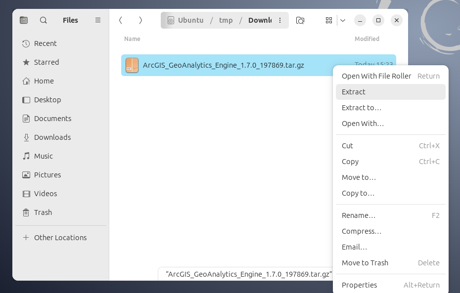

There will be two files – both are tar.gz files and you will need to extract the files from the *.tar.gz file. You may be able to simply right click on the downloaded file and select “Extract [to …]” to extract the GeoAnalytics Engine files.

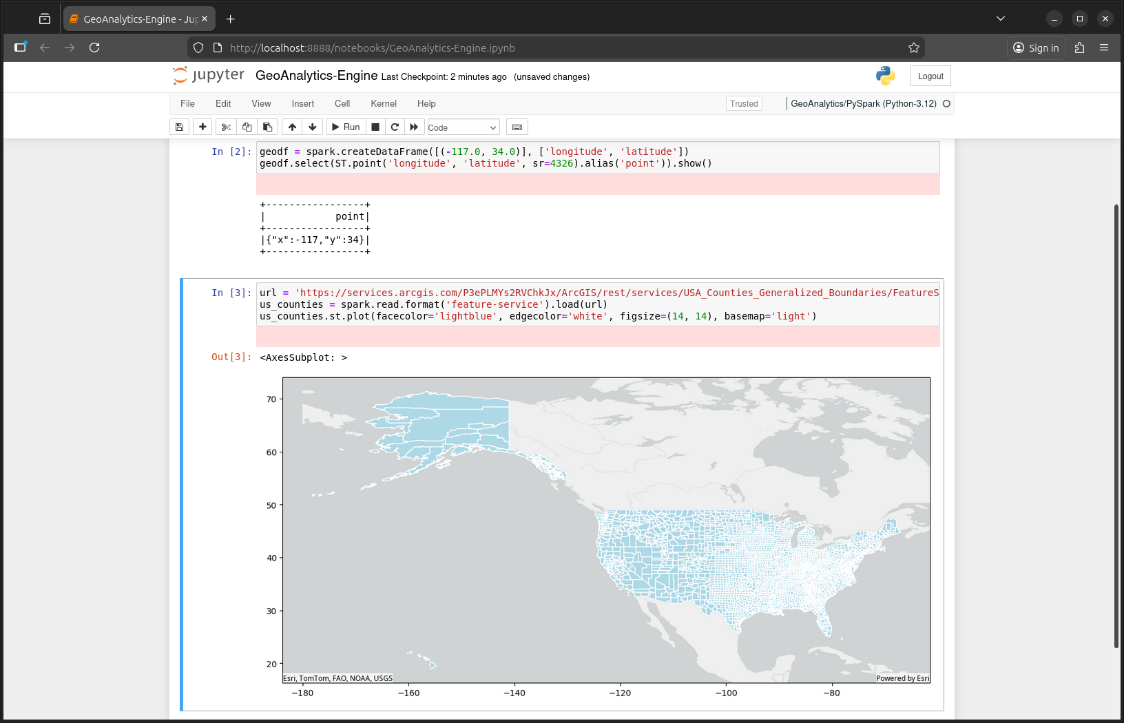

Then we can confirm that everything works by trying some simple code in a Jupyter notebook:
import geoanalytics
geoanalytics.version()
This output of GeoAnalytics Engine version of 1.7.0.213.3871 in the notebook.
We can also check with some basic creation of a DataFrame and plotting a map to confirm that the functionality is all working as expected:
