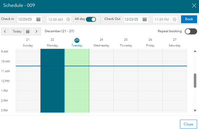

I have Indoors setup in Enterprise 11.5I have added reservation managers to my Workspace Areas, however we are not seeing the toggle to reserve a workspace for another occupant when booking in the Indoor Viewer. The unit is assigned to the Workspace Area. Is this a configurable setting? Where should we see the "Reserve for Someone Else"?I'm referencing: https://doc.arcgis.com/en/indoors/11.5/space-planner/manage-people-and-spaces.htm#:~:text=You%20can%20assign%20one%20or%20more%20reservation%20managers%20to%20a%20workspace%20area.%20Reservation%20managers%20can%20manage%20bookings%20for%20office%20hotels%20and%20meeting%20rooms%20on%20behalf%20of%20other%20people%20in%20Indoors%20Viewer%20and%20Indoors%20mobile%20apps%20that%20have%20workspace%20reservations%20configured%20using%20the%20Reservations%20layer.
After working with Esri tech support the solution was found to be in the Indoor Viewer web map - Units must be the Feature Layer, not the map image layer. Occupants must be renamed to People.
