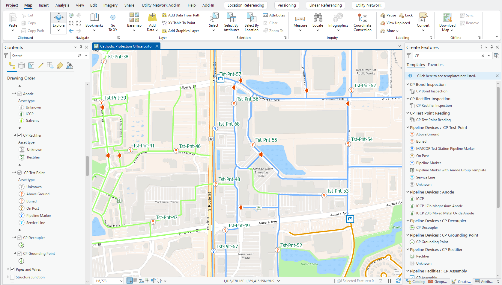

GIS professionals responsible for documenting the location of newly installed CP assets are familiar with desktop tools such as ArcGIS Pro for placing these components. This location and asset descriptor information is automatically stored in a Geodatabase. Once stored, it is immediately available to all organization users for viewing, querying, and analysis.

What if mapping the CP asset in ArcGIS also automatically initializes the compliance dates? This would be a single edit operation. In most CP organizations today, there are two edit operations: one to map the asset and one (in another system) to initiate compliance date management.
The spring 2026 release of UPDM 2026 adds a couple of attribute rules to the PipelineDevice featureclass. These attribute rules will automatically calculate the “Last Inspection Date”, “Next Inspection Date”, and “Compliance Date” fields for the newly placed CP asset.

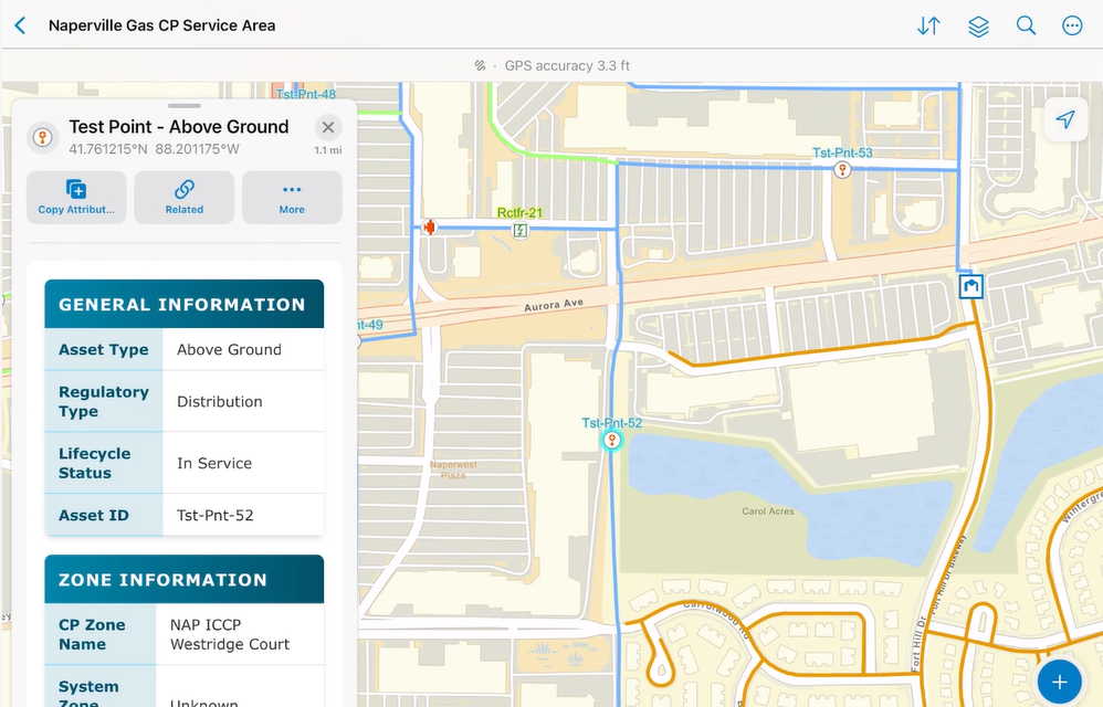

By combining mapping with the initialization of compliance dates, a CP asset, such as a CP Test Point or CP Rectifier, is now ready for a CP technician to perform the federally required inspection.
ArcGIS and its Field Maps mobile application enables CP professionals to easily perform this field inspection activity. It is important to understand that performing the field inspection is only one part of the field activity. The other part is to have the information available to understand the results. Here again, recent advancements in the management of related records and the ability to create a graph of historical readings for a designated asset addresses a core need of CP field technicians.

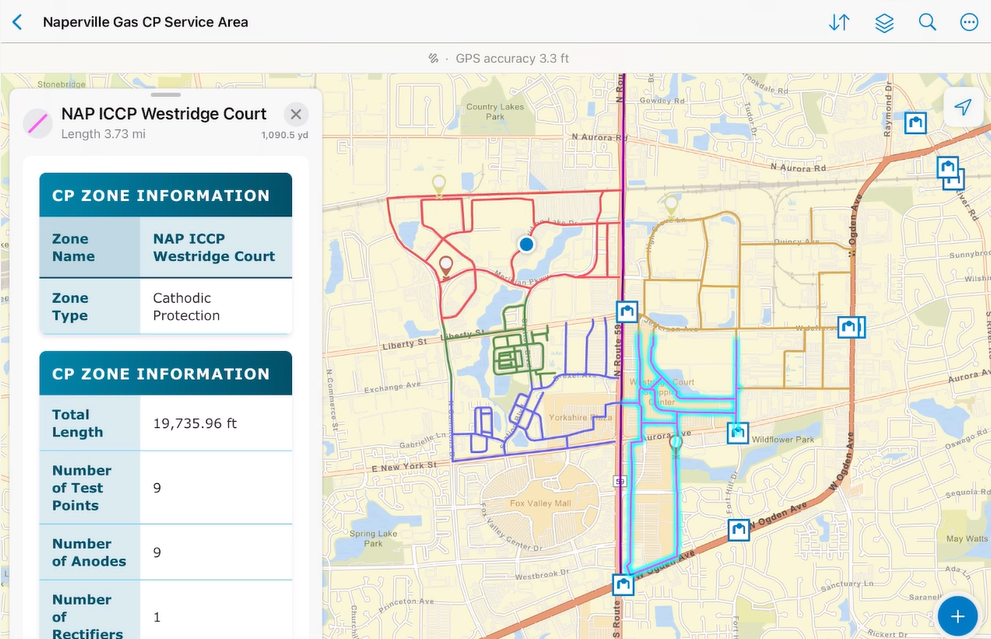

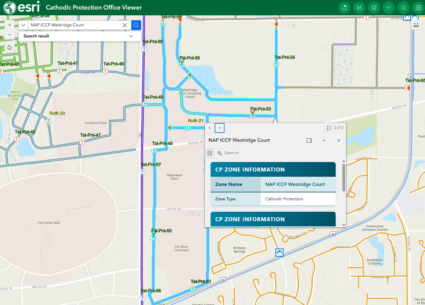

Leveraging the capabilities of ArcGIS Utility Network, and the CP capabilities defined within the natural gas and pipeline industry data model, UPDM, the CP circuits/zones can be automatically generated.
These CP circuits generated by ArcGIS are more than graphical representations; they are models of the electrical flow. The models also tabulate summary information for the CP circuit/zone, including its total length and the number of anodes connected to it.
When a CP technician is in the field trying to determine the cause of a failed CP circuit/zone, a circuit/zone is not visible to the technicians since it is buried under about a meter of dirt. Having an interactive map that not only displays each unique CP circuit but also shows a little blue dot indicating where you are in relation to those circuits provides the simplicity of understanding they have long been looking for.
