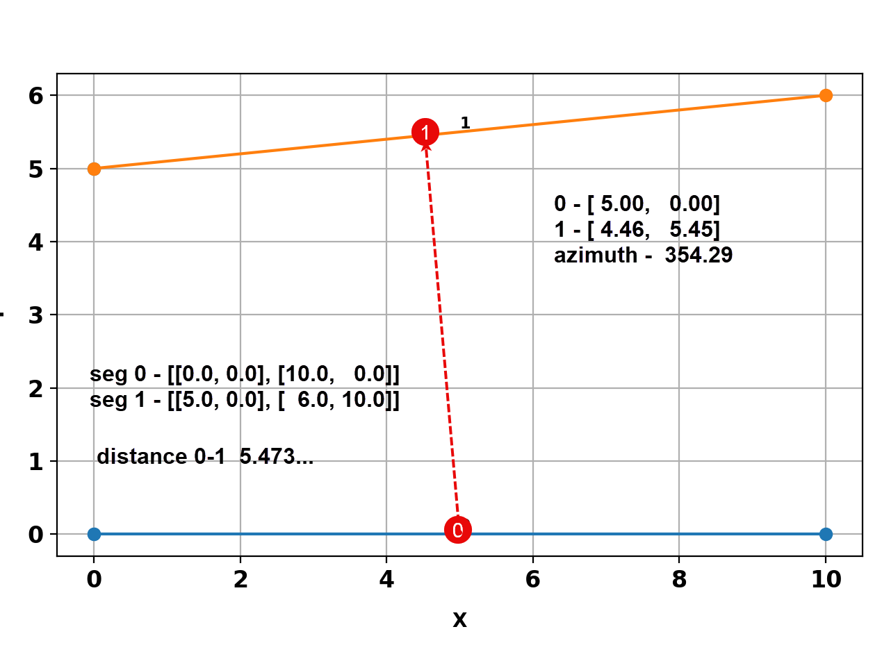

Start at a point, in this case a point midway along a line. (seg0, and pnt0)
Find the point on the next line that is closest to it. (seg1 and pnt1)
Return basic information, like azimuth and distance.

Do a run
# planar coordinates in, euclidean values out
seg0 = np.array([[0., 0.], [10., 0.]])
seg1 = np.array([[0., 5.], [10., 6.]])
pnt0 = np.mean(seg0, axis=0)
pnt1 = _pnt_on_seg_(seg1, pnt0)
azim = _line_dir_(pnt0, pnt1, True) # azimuth, use ...False to get angle
d_01 = np.linalg.norm(pnt0 - pnt1) # euclidean distance
azim, d_01
354.29, 5.472704546154941

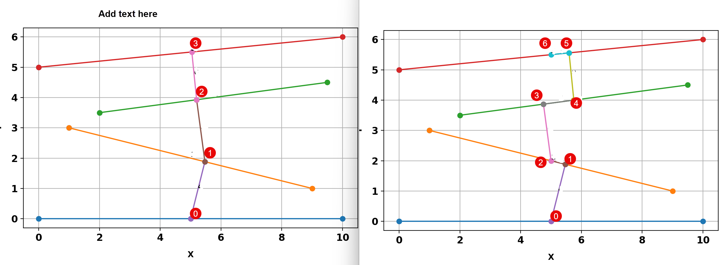

And another couple of options.
The first is with the first segment location specified, then the location of the remaining points are calculated.
The second is with each segment having a specified location (50% along line) and closest points calculated between each. The final line extending upwards connects those in sequence.
