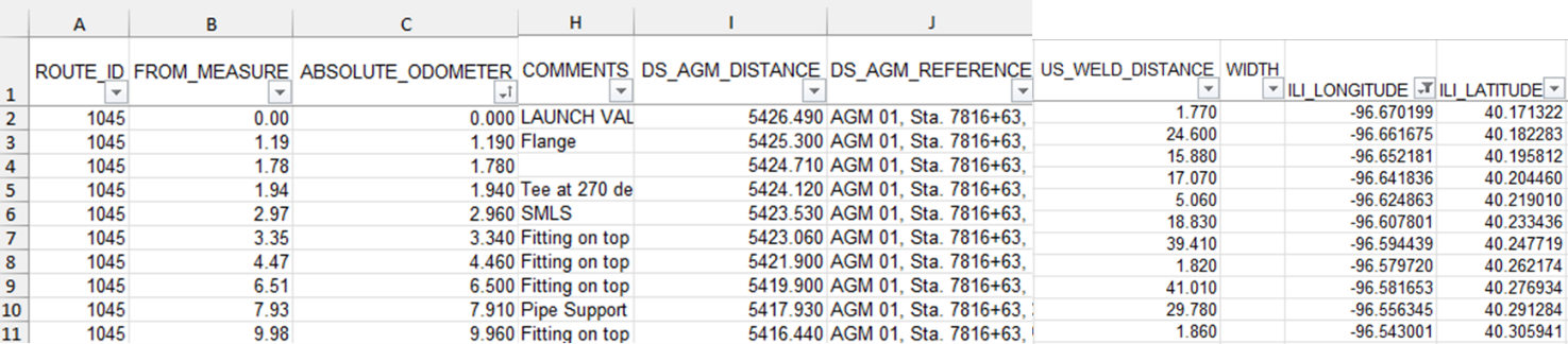

ILI data can be delivered in a number of formats such as CSV, Excel, dbTable etc. ILI data typically has odometer/measure attribution for linear referencing. In some cases, the location data is provided in terms of latitude and longitude that can be used for spatialization.
The following samples show what raw ILI run would look like in an Excel file:

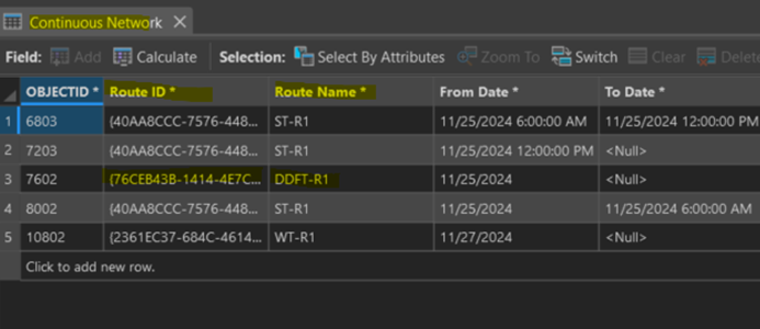

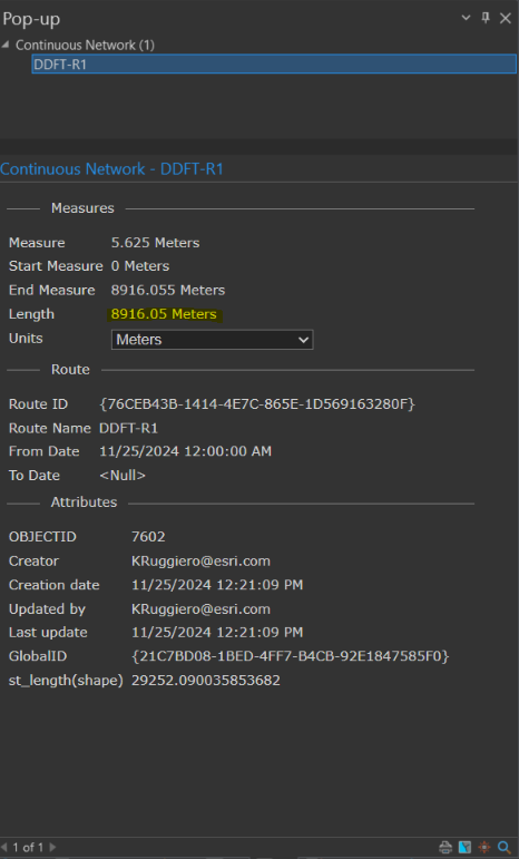

As discussed previously, the LRS network choice of engineering route or ILI route, is a key parameter that determines the calibration process of the ILI data. If ILI network is chosen, use the ArcGIS Pro tool Points to Line to first create a centerline using the raw ILI survey data. Using the centerline, create a route, specific to the ILI Run using the Location Referencing Tools in ArcGIS Pro. In this case, a continuous Route called DDFT-R1 is created representing the ILI run.

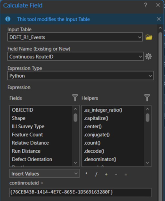

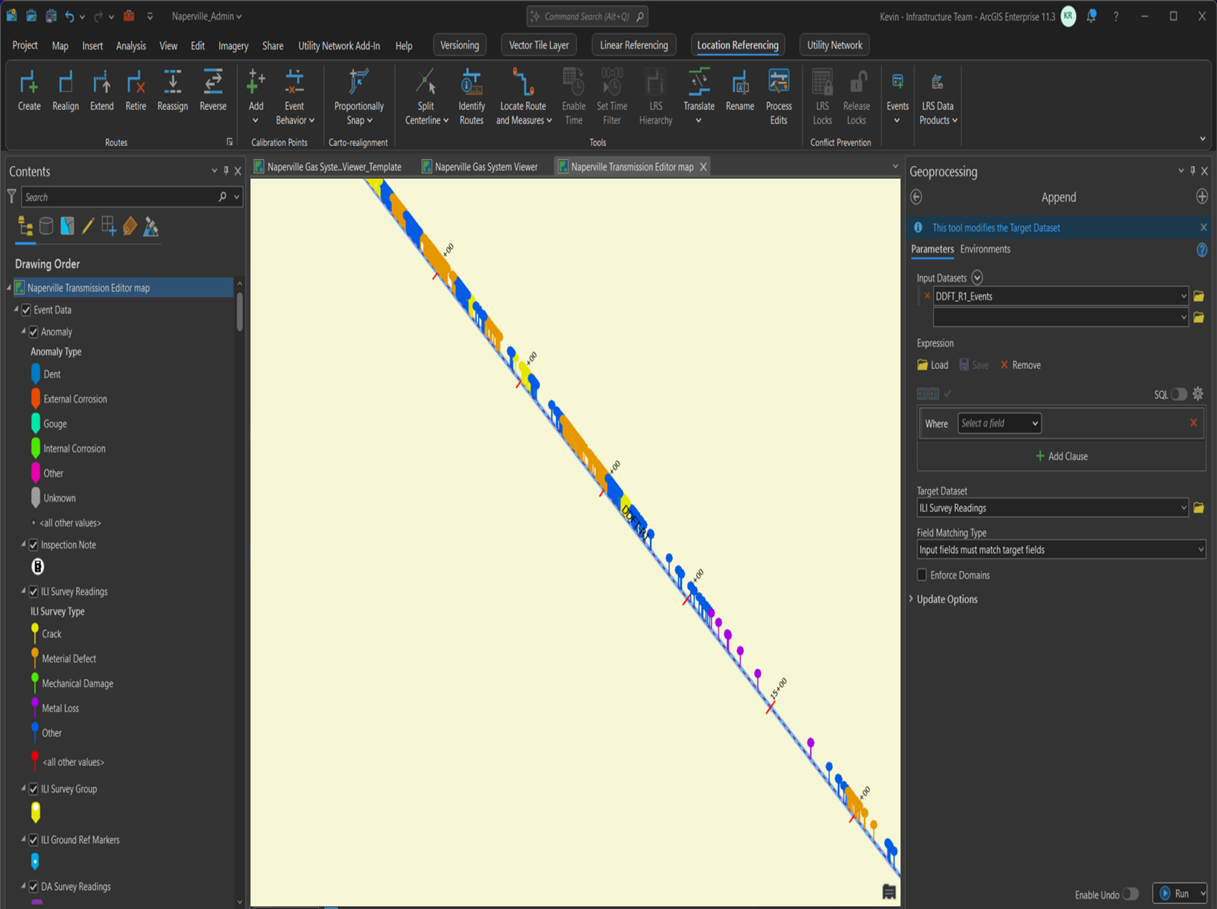

Whether you use an engineering route or an ILI route, the attributes of the route identifier (RouteID) and Measure on the ILI data points must correlate to the route parameters. Loading the ILI data is achieved by Pipeline Referencing tool Append Events to the ILI Survey event layer. The RouteID and Measure fields must be populated that allows to associate ILI data to the correct route. The RouteID can be obtained from the LRS network attribute table or by identifying the route feature.
Calculate the RouteID and other fields required for the ILI Survey event layer as defined in the data model. You can Copy and Paste them into a calculation that populates the fields as shown.

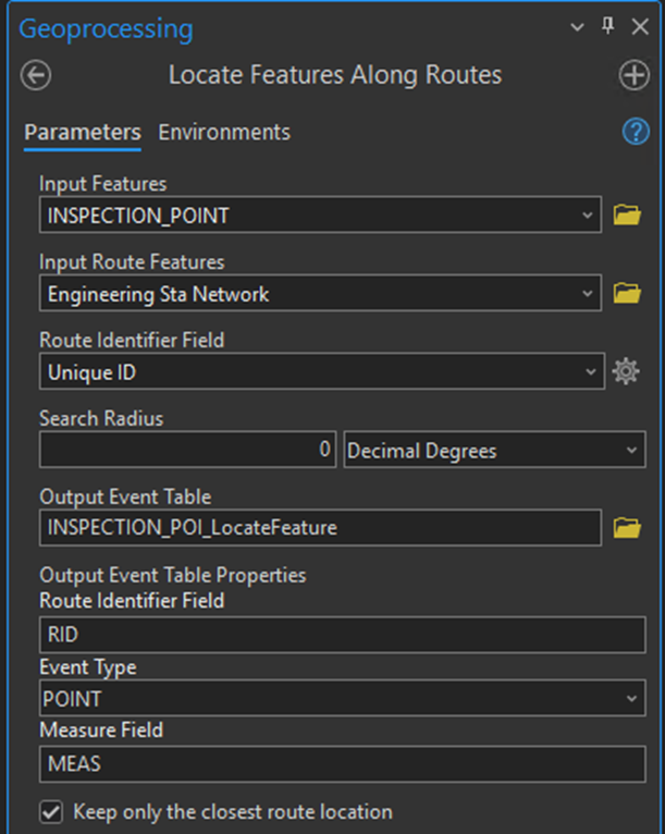

Alternately, the ArcGIS Pro tool Locate features along route can be used, if RouteID and Measure are missing in the ILI data. The geoprocessing tool intersects the input point features and route features and writes the route and measure information to a new event table.

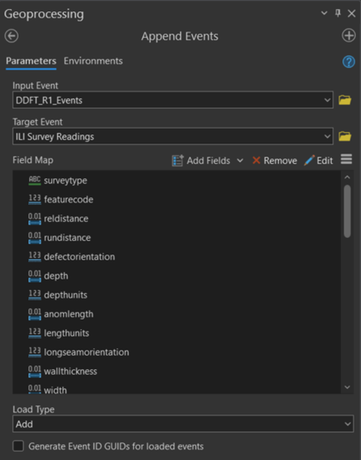

4. Appending Events
Once the ILI data is processed and formatted per the LRS event requirements, use the Append Events to load the data to the APR managed ILI Survey event layer.
The ILI data is now loaded into your GIS by referencing an LRS route network of choice. If you had domain codes in your captured data, you could match those domains when you load your data to the ILI Survey event layer.
