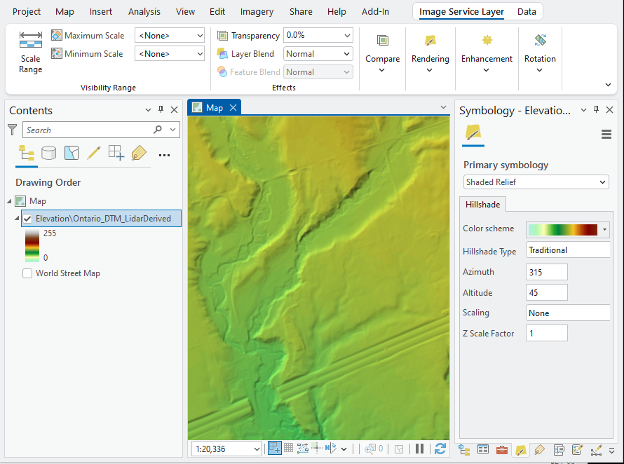

I can open the .LYR file in ArcGIS Pro and change the symbology to Shaded Relief.

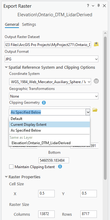

- Right-click the layer in the Contents pane > Data > Export raster.
- Change the Output Format to JPG.
- Change the Clipping Geometry to Current Display Extent.
- Change the Renderer Settings to Force RGB and User Renderer.
Problem:
Failed to export Elevation\Ontario_DTM_LidarDerived: The Output raster could not be created in the specified format with specified pixel type or number of bands or colormap.
