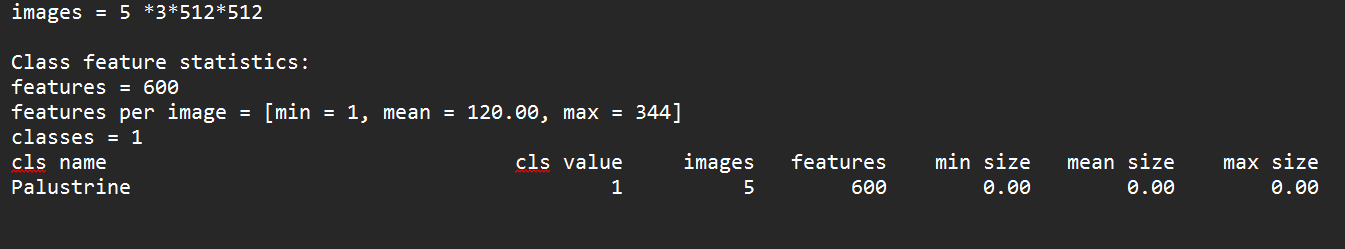

Here's a snippet of stat file

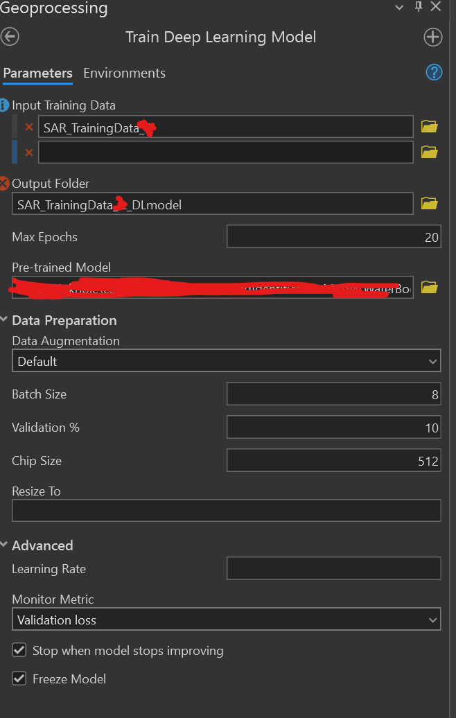

Tool

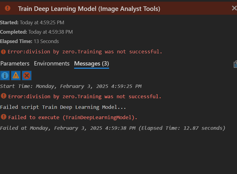

Error

@Ed_ looks like you have 6 image chips in the training data..

hi @Ed_ we need to handle this error bit better and provide you with actionable information. One reason that I have seen this occur is that when the batch size is larger than the number of chips in the data, the Train Deep Learning Model tool may return "ZeroDivisionError: division by zero" in this case.
It looks like you have 5 images chips and your batch size if 8.
I am on the latest version of Pro that is 3.4.2. I am surprised that it's giving me the zero division error, because as you can see in the above stat file screenshot, the training data has 600 features.
