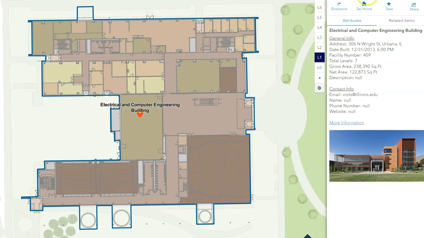

Campus Facility Viewer: Combining building photos with the floor-aware Indoor Viewer is a great way to share a high-level overview of facility data with both staff and the general public.

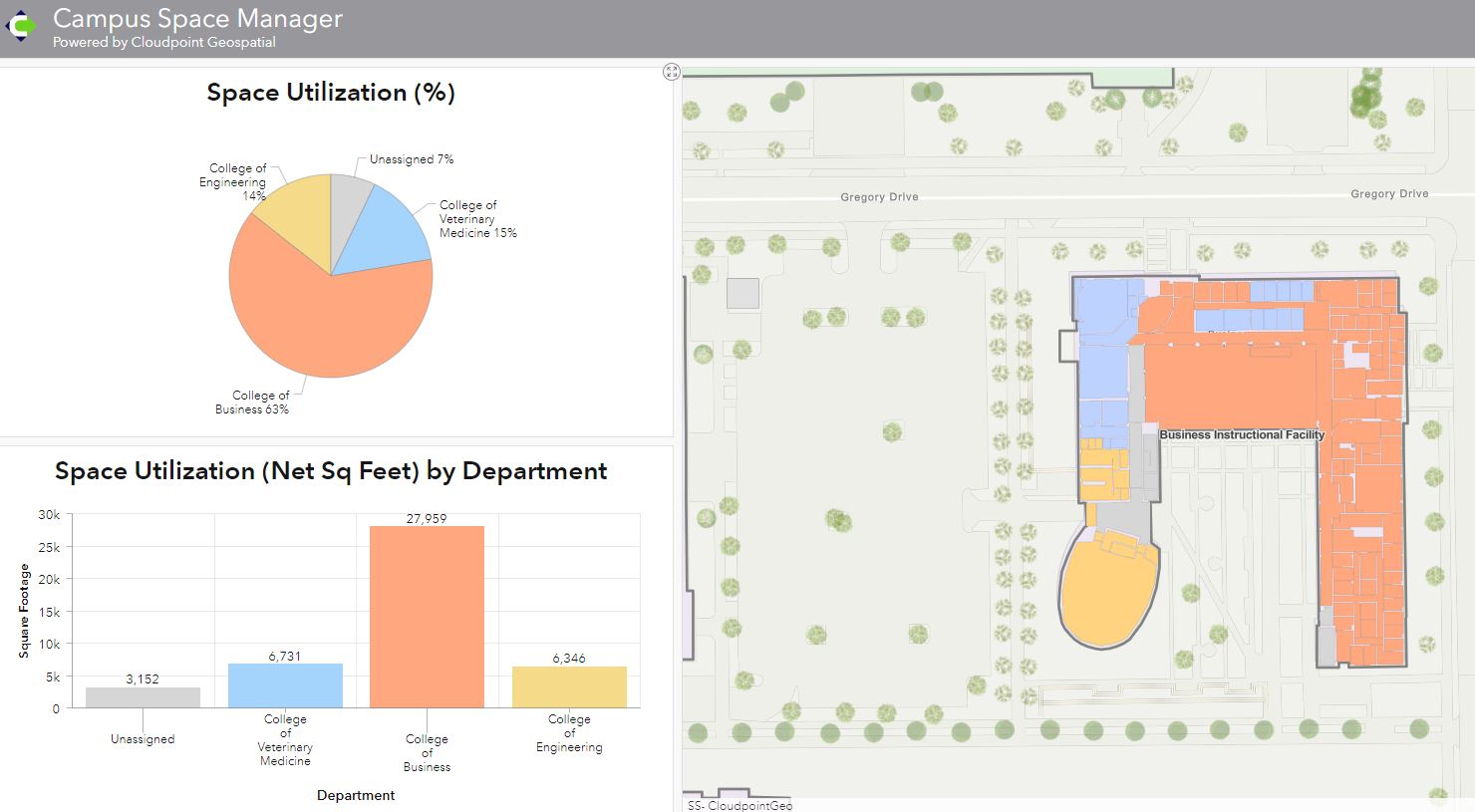

Campus Space Manager: Floor aware maps can make sharing space usage statistics much easier and more engaging when they add a visual representation of the space.
