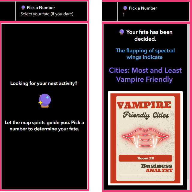

Activity Recommender
This is a nicely styled Details element that uses my activities layer. My dashboard doesn't include a map, so I applied the pop-up style directly to the layer using the Visualization tab in the Item Details. The Details element is powered by a Numeric Selector. I have the Details element set to only render when filtered and changed the No Selection message to something more fortune teller-y. Pick a card number and see your results. Now you can see why I needed to add unique numbers to my dataset.
Render only when filtered
