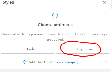

How can I display features based on dates using ArcGIS Arcade? For example, no dates that exist in the future. Only starting from the current date or prior. This should be possible with a style expression correct?
This is the live csv: https://cwwp2.dot.ca.gov/data/d7/lcs/lcsStatusD07.csv (the fields to be used would be the closureStartDate and closureEndDate)
Yes, you can do that. You'd want an expression like:
return Iif( DateDiff(Today(), $feature.yourDateField) >= 0, 'Past/Present', 'Future' )
Then simply leave the "Future" category out of your symbology, or set it to be completely transparent.
Thank you! This works nicely.
