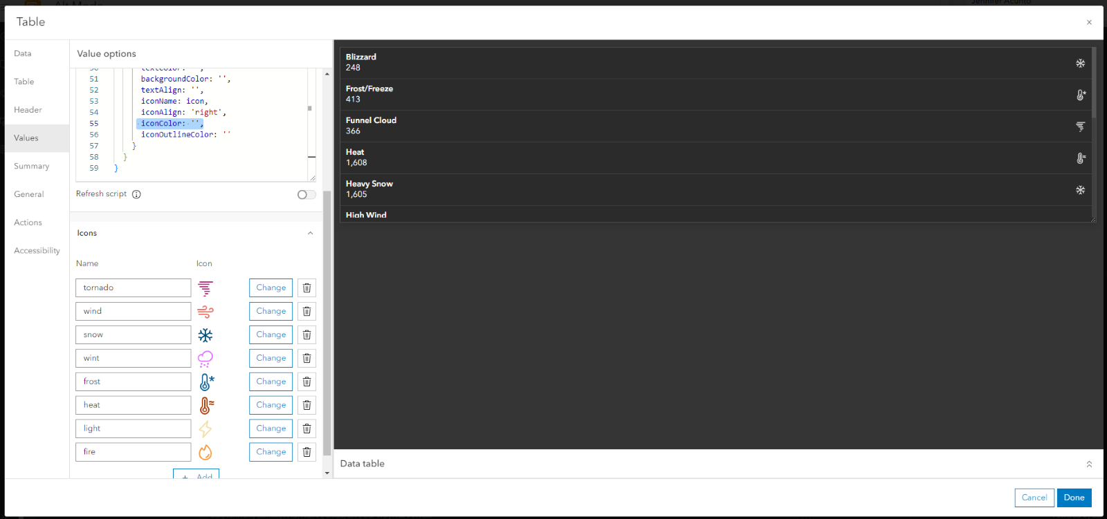

I decided that if I have to have that column, then i will simply repurpose it.
I added some custom icons and used Arcade to dynamically display the icon and color.
Arcade + Custom Icons
Note, dashboard will override the icon color, so if you don’t specify it in the return statement, they will be the default color, even if the actual icon you added has color.
