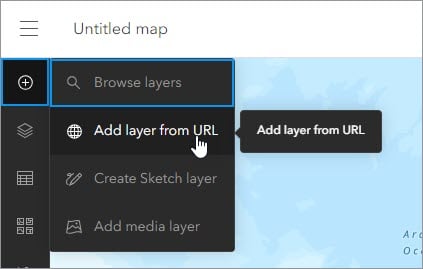

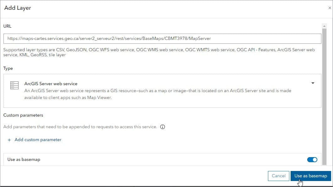

I do not see this function in our MapViewer or MapViewer Classic. Is this a new release that shows the function to use as basemap? I need to record the Lat,Long in USFeet for our editable feature. Is there another way to add the projection to teh map or a script to enter as an expression to code for the change from the default projection. thank you
Hi - It's possible that you are trying to add a layer type that's not supported as a basemap. Supported layer types are imagery, map image, tile, vector tile, WMS OGC, WMTS OGC, Bing, and OpenStreetMap.

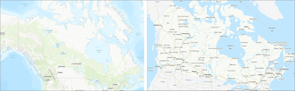

Hello,
Would it be possible for Esri Canada to create a basemap using the Lambert Conformal Conic in the same style as the "Light Gray Canvas"? The one referenced here does not allow for close zooming in, particularly at the street level. The labels in the Light Gray Canvas is also cleaner.
Thank you!
Jenny
Hi @JennyKuan - The best way to request the basemap you are looking for is to contact communitymaps@esri.ca. Hope this helps!
Bedankt voor deze informatie, Jennifer. Ik heb een paar video's gezien (één van Esri) waarin specifiek wordt gezegd dat we Rest-servers hiervoor kunnen gebruiken, maar het werkt bij mij nooit. Nu ik deze lijst zie, waarin Rest-servers niet zijn opgenomen, verklaart dat misschien waarom??
